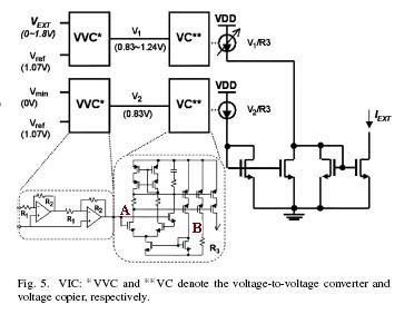

In the paper 'A Wideband CMOS Variable Gain Amplifier With an Exponential Gain Control',a Voltage-to-Current Converter is realized and the structure is shown  in  the following figure。
In the figure,VC** denotes the voltage copier and current generation。here  i don't understand why VC** can copy voltage from node A to node B。
Could anybody explain it? thank you。

hi, wwm101
I suspect that the gate of the other NMOS of the differential pair should be connected to node "B". So the negative feedback loop will be established, and all things will make sense. Please think about it, thanx.

Thank you for your reply.
But how to explain the function of the NMOS whose gate is connected to node"A" and source is connected to  the gate of differential pair of the other NOMS at the right side?  thank you.

wwm101 & waveguides:
Sorry to Mr. Waveguides, you are not totally right.
This NMOS is a Slew-Rate-enhancement element. In the case of node A is suddenly higher than node B by Vthn, this NMOS will be turned on very soon. At this transient, the gates of the current mirrors are pulled down, and node B is increased as a consequence.
From this analysis, we can find out that the differential mode input voltage of the differential pair will never be larger than Vthn, which makes the Opamp works in linear region all the time. Also, from this point of view, the NMOS' channel length will be the minimum length allowed in a given process, and its width will be as large as 100um, smaller or bigger, depending on the slew rate requirement.

wind2000sp3 &waveguides:
Thank you very much for your reply.
Here and now ,i  can understand it.

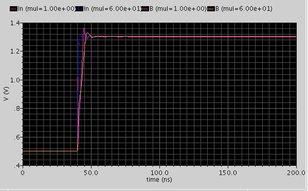

It can work when i connect the gate of the other NOMS of differential pair  at the right side to the node 'B' .

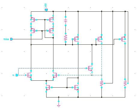

The simulation result   was shown in  the following.
But the result also shows that the NMOS doesn't enhance slew-rate significantly.
schematic
tran simulation result
