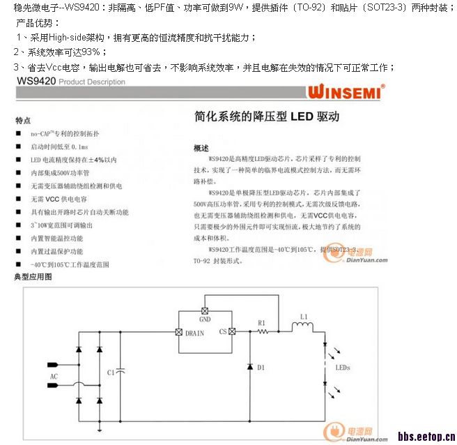

回复 40# hszgl
    this chip inside Vcc LDO
no extra Vcc  pin design
