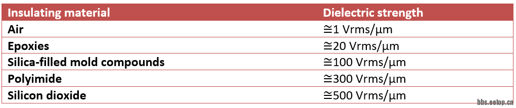

Usually for signal isolation, optical or galvanic isolation is used. I highly doubt if this is polyimide and I think it is epoxy, because epoxy is cheaper and has higher dielectric breakdown value, usually that's the reason for choosing this type of thermosetting material.
发表于 2025-8-4 03:51:54 | 显示全部楼层
Here's a list of insulating material.
