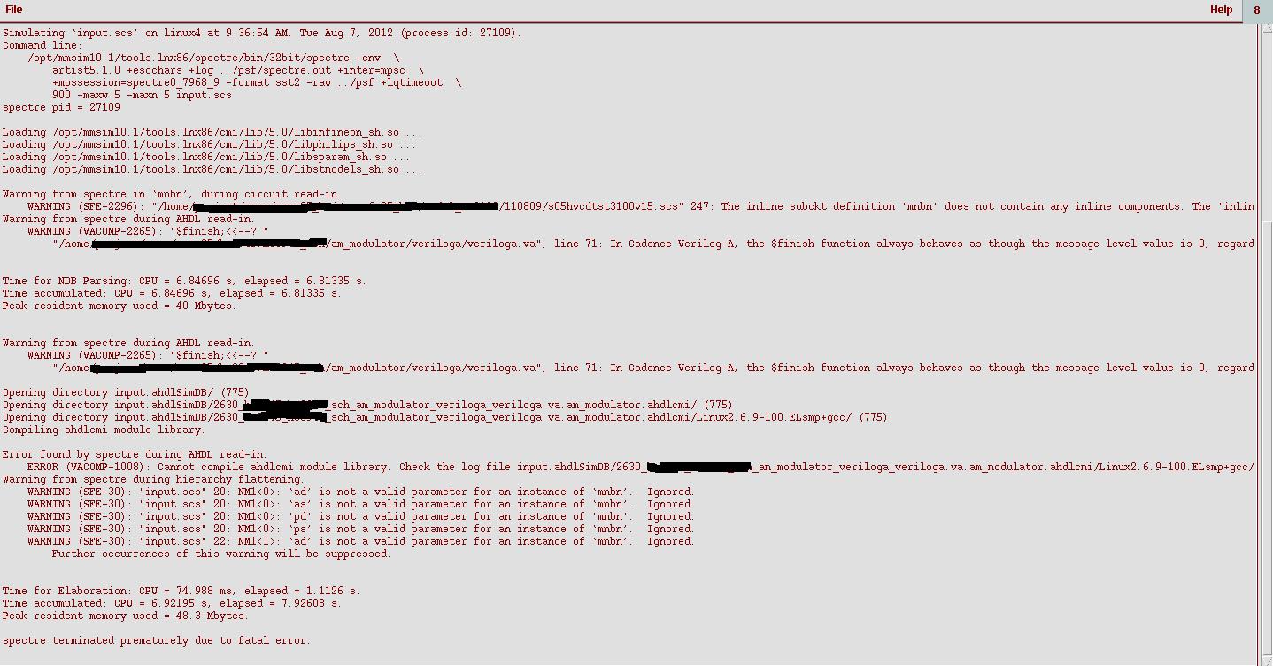

[求助] mmsim10.1的spectre报错,不识别AHDL?
发表于 2012-8-7 09:51:44 | 显示全部楼层 |阅读模式
图片可以点击放大
看过坛子里面类似的一些问题,都是说由于bash引起的系统shell的原因
可是我用的是scientific linux,是redhat else4.9的再封装版本
root默认的就是bash,用户用的是csh
以前用cadence5141 base版本的时候貌似没有这个问题的
是由于mmsim10.1的问题吗?
想请教一下高人,谢谢!!!!!

下面是导出来的文字版的ciw的log
Cadence (R) Virtuoso (R) Spectre (R) Circuit Simulator
Version 10.1.0.204 32bit -- 14 Sep 2010
Copyright (C) 1989-2010 Cadence Design Systems, Inc. All rights reserved worldwide. Cadence, Virtuoso and Spectre are registered trademarks of Cadence Design Systems, Inc. All others are the property of their respective holders.
Protected by U.S. Patents:
        5,610,847; 5,790,436; 5,812,431; 5,859,785; 5,949,992; 5,987,238;
        6,088,523; 6,101,323; 6,151,698; 6,181,754; 6,260,176; 6,278,964;
        6,349,272; 6,374,390; 6,493,849; 6,504,885; 6,618,837; 6,636,839;
        6,778,025; 6,832,358; 6,851,097; 6,928,626; 7,024,652; 7,035,782;
        7,085,700; 7,143,021; 7,493,240; 7,571,401.
Includes RSA BSAFE(R) Cryptographic or Security Protocol Software from RSA Security, Inc.
User: leihj   Host: linux4   HostID: 7F0100   PID: 27109
Memory  available: 5.7270 GB  physical: 8.3372 GB
CPU Type: AMD Athlon(tm) II X2 250 Processor
          Processor PhysicalID CoreID Frequency
              0         0        0     800.0
              1         0        1     800.0
Simulating `input.scs' on linux4 at 9:36:54 AM, Tue Aug 7, 2012 (process id: 27109).
Command line:
    /opt/mmsim10.1/tools.lnx86/spectre/bin/32bit/spectre -env  \
        artist5.1.0 +escchars +log ../psf/spectre.out +inter=mpsc  \
        +mpssession=spectre0_7968_9 -format sst2 -raw ../psf +lqtimeout  \
        900 -maxw 5 -maxn 5 input.scs
spectre pid = 27109
Loading /opt/mmsim10.1/tools.lnx86/cmi/lib/5.0/libinfineon_sh.so ...
Loading /opt/mmsim10.1/tools.lnx86/cmi/lib/5.0/libphilips_sh.so ...
Loading /opt/mmsim10.1/tools.lnx86/cmi/lib/5.0/libsparam_sh.so ...
Loading /opt/mmsim10.1/tools.lnx86/cmi/lib/5.0/libstmodels_sh.so ...
Warning from spectre in `mnbn', during circuit read-in.
    WARNING (SFE-2296): "/home/涂黑替代/s05hvcdtst3100v15.scs" 247: The inline subckt definition `mnbn' does not contain any inline components. The `inline' qualifier will therefore be ignored.
Warning from spectre during AHDL read-in.
    WARNING (VACOMP-2265): "$finish;<<--? "
        "/home/涂黑替代_sch/am_modulator/veriloga/veriloga.va", line 71: In Cadence Verilog-A, the $finish function always behaves as though the message level value is 0, regardless of the value you specify: The simulator does not report simulation time, location, or statistics about memory and CPU time usage.
Time for NDB Parsing: CPU = 6.84696 s, elapsed = 6.81335 s.
Time accumulated: CPU = 6.84696 s, elapsed = 6.81335 s.
Peak resident memory used = 40 Mbytes.
Opening directory input.ahdlSimDB/ (775)
Opening directory input.ahdlSimDB/2630_涂黑替代_sch_am_modulator_veriloga_veriloga.va.am_modulator.ahdlcmi/ (775)
Opening directory input.ahdlSimDB/2630_涂黑替代_sch_am_modulator_veriloga_veriloga.va.am_modulator.ahdlcmi/Linux2.6.9-100.ELsmp+gcc/ (775)
Compiling ahdlcmi module library.
Error found by spectre during AHDL read-in.
    ERROR (VACOMP-1008): Cannot compile ahdlcmi module library. Check the log file input.ahdlSimDB/2630_涂黑替代sch_am_modulator_veriloga_veriloga.va.am_modulator.ahdlcmi/Linux2.6.9-100.ELsmp+gcc/../ahdlcmi.out for details. If the compiler ran out of memory, use 'setenv CDS_CMI_COMPLEVEL 0', and try again. If the reason for the failure was a syntax error, contact your Cadence Customer Support representative with the netlist, log files, behavioral model files, and any other information that can help identify the problem.
Warning from spectre during hierarchy flattening.
    WARNING (SFE-30): "input.scs" 20: NM1<0>: `ad' is not a valid parameter for an instance of `mnbn'.  Ignored.
    WARNING (SFE-30): "input.scs" 20: NM1<0>: `as' is not a valid parameter for an instance of `mnbn'.  Ignored.
    WARNING (SFE-30): "input.scs" 20: NM1<0>: `pd' is not a valid parameter for an instance of `mnbn'.  Ignored.
    WARNING (SFE-30): "input.scs" 20: NM1<0>: `ps' is not a valid parameter for an instance of `mnbn'.  Ignored.
    WARNING (SFE-30): "input.scs" 22: NM1<1>: `ad' is not a valid parameter for an instance of `mnbn'.  Ignored.
        Further occurrences of this warning will be suppressed.
Time for Elaboration: CPU = 74.988 ms, elapsed = 1.1126 s.
Time accumulated: CPU = 6.92195 s, elapsed = 7.92608 s.
Peak resident memory used = 48.3 Mbytes.
spectre terminated prematurely due to fatal error.

你好,兄弟,我的是scientific linux6.2,是RHEL6.2的再封装版本,也是碰到了ahdlcmi这个问题,我估计跟系统无关,应该是MMSIM版本过高的问题
这里面应该有具体error信息, 贴出来看看? 系统问题的确是个可能, 比如gcc版本不对.
