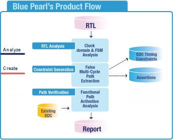

Identifies false and multi-cycle paths from RTL descriptions and writes SDC timing constraints for implementation as well as SVA or PSL assertions for verification. Create reduces iterations in the flow to achieve timing closure faster, minimizing design risk.
The Blue Pearl Visual Verification environment consists of four tools that allow you to evaluate, verify, understand and take full advantage of the constraints and assertions generated by the Blue Pearl Software Suite. The False & Multi-cycle Path Audit Trail Viewer and the Assertion Audit Trail Viewer are associated with the Create product.
Both tools consist of three dockable sub-windows within a main schematic window that show a color-coded view of only the selected path. The first sub-window in the Assertion Audit Trail Viewer is a list of assertions. Selecting an assertion from this list opens a filterable list of false paths associated with that assertion. The first sub-window in the False & Multi-cycle Path Audit Trail Viewer (see below) is a filterable list of false and multi-cycle paths from the current design.

The Blue Pearl Software Suite is built with industry-leading symbolic simulation technology to automatically generate the timing exceptions from RTL code. With Blue Pearl, designers can accomplish in just a few short hours what might normally take designers many weeks of work.Features & Benefits:
  • Fast FSM and control behavior analysis
  • Sequential analysis of false and multi-cycle paths
