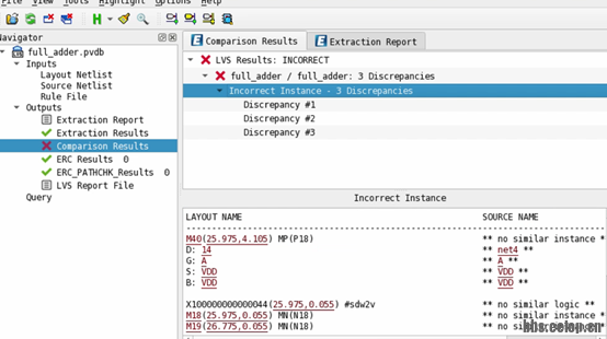

具体报错如下:
LAYOUT NAME                                               SOURCE NAME
M40(25.975,4.105) MP(P18)                                 ** no similar instance **
D: 14                                                     ** net4 **
G: A                                                      ** A **
S: VDD                                                    ** VDD **
B: VDD                                                    ** VDD **
X100000000000044(25.975,0.055) #sdw2v                     ** no similar logic **
M18(25.975,0.055) MN(N18)                                 ** no similar instance **
M19(26.775,0.055) MN(N18)                                 ** no similar instance **
** no similar logic **                                 X200000000000055 #nand2v
** no similar instance **                                 XI1/MNM1 MN(N18)
** no similar instance **                                 XI1/MNM0 MN(N18)
** no similar instance **                                 XI1/MPM1 MP(P18)
** no similar instance **                                 XI1/MPM0 MP(P18)
报错集中在该NAND,其他两个NAND和其他子模块无报错,连线没检查出问题,单个子模块过了DRC和LVS,整体也过了DRC。

先跑drc,如果drc没有问题还是有可能连线有错的,看着报错有点乱呢,显示版图中有pmos电路中没有,电路中有nand版图中没有
发表于 2025-10-15 10:53:44 | 显示全部楼层

连线没问题可以看看DRC,可能是某些层次影响了器件的识别

看着像是布线有问题,可以点亮这个器件的各个端口看下

--------------------------- CELL COMPARISON RESULTS ( TOP LEVEL ) ---------------------------
                        ####    #####     #     #                 FAIL
LAYOUT CELL NAME=full_adder
SOURCE CELL NAME=full_adder
--------------------------------- HCELL ERRORS AND WARNINGS ---------------------------------
  Error:    Numbers of instances not equal.
===================================== OBJECT STATISTICS =====================================
o Before Transform
                Layout          Source         Component Type
Ports:                    7               7
Nets:                    27              27
Instances:               22              22         MN (4 pins) (D S) G B
                          22              22         MP (4 pins) (D S) G B
Total Inst:              44              44
o After Transform
Ports:                    7               7
Nets:                    18              18
Instances:                1               0    *    MP (4 pins) (D S) G B
                           4               4         #invv (4 pins)
                           1               0    *    #sdw2v (4 pins)
                           8               9    *    #nand2v (5 pins)
Total Inst:              14              13
       * = Object numbers are different.
============================== INFORMATION AND WARNINGS =====================================
                  Matched    Matched    Unmatched    Unmatched    Component
                   Layout     Source       Layout       Source    Type
   Ports:               7          7            0            0
   Nets:               18         18            0            0
   Instances:           0          0            1            0    MP(P18)
                        4          4            0            0    #invv
                        0          0            1            0    #sdw2v
                        8          8            0            1    #nand2v
   Total Inst:         12         12            2            1
o Statistic Data:
    2 layout mos transistors were merged to 1.
      1 mos transistor was deleted by parallel mergence.
o Initial Matching Nets And Instances:
   Ports:        A B C0 C1 S VDD VSS
各位大佬,小弟这个报错的器件是自己画的版图然后调用的,三个器件只有第二个有问题,不知道这些操作有什么可能会出错导致问题的地方。谢谢了
