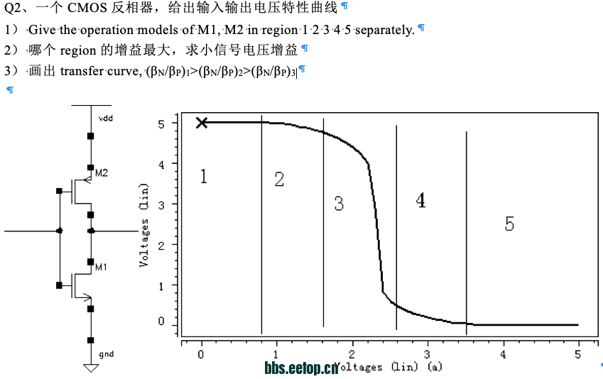

[求助] CMOS反相器

It's not transfer characteristic of CMOS, because in static the CMOS power consumption null.
发表于 2020-6-29 15:04:53 | 显示全部楼层
A-a-a the axis siffted!!
发表于 2020-6-29 15:10:06 | 显示全部楼层
1 pch in saturation, nch close
2 pch in saturation, nch in linear
3 pch in saturation, nch in saturation
4  pch in linear, nch in saturation
5  pch in close, nch in saturation

 楼主| 发表于 2020-6-29 16:38:11 | 显示全部楼层
3 pch in saturation, nch in satura ...
请问第三问是什么意思啊,看不懂
发表于 2020-6-29 17:16:24 | 显示全部楼层
第三问应该是电流和电压的关系 你这个还有第三个mos管,也看不见啊
