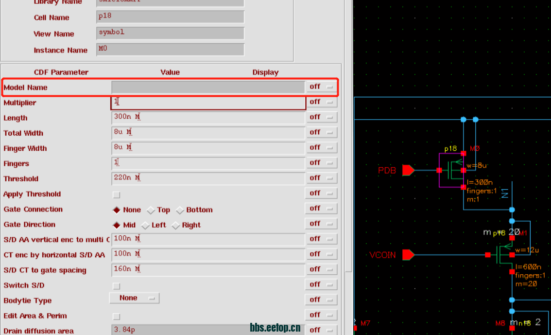

[求助] model name修改不了,怎么批量替换?

或许也可以试试在hspice仿真输入中用这个语句alias模型名.
.MALIAS
Assigns an alias to a diode, BJT, JFET, or MOSFET model that you defined in a .MODEL command.
Syntax
.MALIAS model_name=alias_name1 [alias_name2 ...]
Argument
Description
model_name
Model name defined in the .MODEL card
alias_name1...
Alias that an instance (element) of the model references
Description
Use this command to assign an alias (another name) to a diode, BJT, JFET, or MOSFET model that you defined in a .MODEL command.
.MALIAS differs from .ALIAS in two ways:
\u2022A model can define the alias in an .ALIAS command, but not the alias in a .MALIAS command. The .MALIAS command applies to an element (an instance of the model), not to the model itself.
\u2022The .ALIAS command works only if you include .ALTER in the netlist. You can use .MALIAS without .ALTER.
You can use .MALIAS to alias to a model name that you defined in a .MODEL command or to alias to a subcircuit name that you defined in a .SUBCKT command. The syntax for .MALIAS is the same in either usage.

model name是由cell name决定的,不可编辑,如果是要替换管子类型的话,去修改cell name即可,批量修改方式是选中需要替换的管子并选择all selected,再把管子类型改成你需要的即可

untitled1.png 额本来是这样的,也不知道怎么设置出来的,这种形式。用edit--->replace后,model就默认变成了pch。
后来把箭头的pch删掉了,又弄了一遍替换,model也变成空的了。
spectre可以跑,但是hspice导出来就就不对了,因为model name是空的导出的都叫hnmos。
除非重新调用一个,不然model还是空的,感觉好像是给编辑上了什么属性。
现在只好挨个点“Defaults”,再重新设一遍尺寸参数。

     如果工艺 A 换 工艺B  ?
Composer 那 selected好像同一套工艺库内换 .
