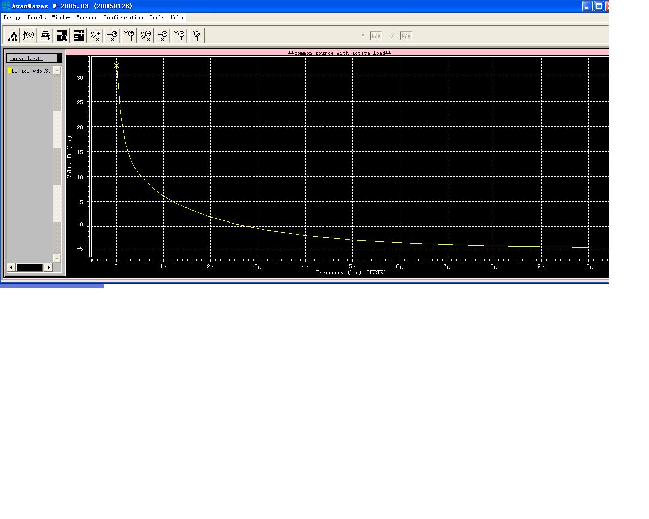

仿真结果在附件,结果不对,错在什么地方呀?
程序如下:
**common source with active load**
vdd   1   0          dc 5
ibias 2   0          dc 100u
m3    2   2   1   1  pch w=100u l= 1.6u
m2    3   2   1   1  pch w=100u l= 1.6u
m1    3   4   0   0  nch w=100u l= 1.6u
vin   4   0          dc 0.849 ac 1
.op
.ac dec 10 1k 10000Meg
.print vdb(3)
.option post
.model nch nmos((level=2 LD=0.15U  NSUB=5.37E+15
+ VTO=0.74 KP=8.0E-05 GAMMA=0.54 PHI=0.6 U0=656 UEXP=0.157 UCRIT=31444
+ DELTA=2.34 VMAX=55261 Xj=0.2U LAMBDA=0.037 NFS=1E+12 NEFF=1.001 NSS=1E+11
+ TPG=1.0 RSH=70.00   CGDO=4.3E-10 CGSO=4.3E-10 Cj=0.0003 Mj=0.66
+ CJSW=8.0E-10 MJSW=0.24 PB=0.58
.model pch pmos(level=2 LD=0.15U  NSUB=4.33E+15
+ VTO=-0.74 KP=2.70E-05 GAMMA=0.58 PHI=0.6 U0=262 UEXP=0.324 UCRIT=65720
+ DELTA=1.79 VMAX=25694 Xj=0.25U LAMBDA=0.061 NFS=1E+12 NEFF=1.001 NSS=1E+11
+ TPG=1.0 RSH=121.00
+ CGDO=4.3E-10 CGSO=4.3E-10 Cj=0.0005 Mj=0.51
+ CJSW=1.35E-10 MJSW=0.24 PB=0.64
.end

发表于 2007-9-9 04:00:48 | 显示全部楼层
为什么不对呢?
你想要的是横轴对数显示的结果?
 楼主| 发表于 2007-9-9 11:15:18 | 显示全部楼层
带宽不对呀
怎么看对数结果?
