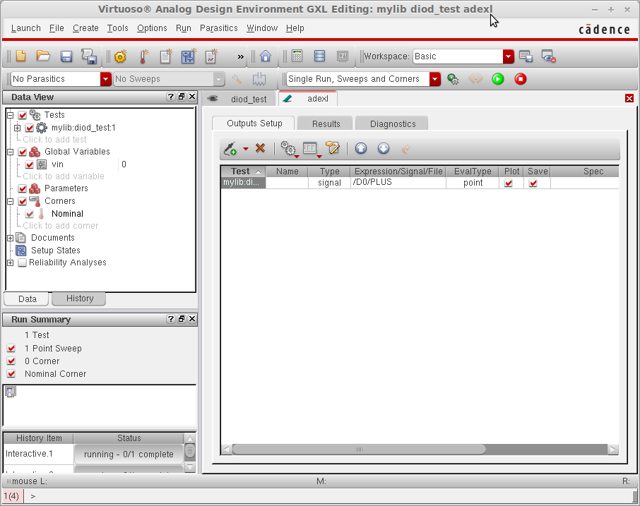

probably ADE GXL will not work
i try ubuntu ,mint, fedora, ADE GXL not work correctly but all version mandriv,a mageia, centos work very good

Screenshot from 2012-09-12 23:50:48.png 回复 3# ceaphacr@fakein
   好像我的能工作。

If you run the simulation will you get a result. I had same situation with Fedora but it does not give me any result, simulation hangs at the start and does not give any error only sits and waits. Please report. Thanks in advance.

Using Fedora GXL simulation does not start to run and waits happily forever without any error report. Is this because some missing library in Linux distribution? Thanks in advance.
