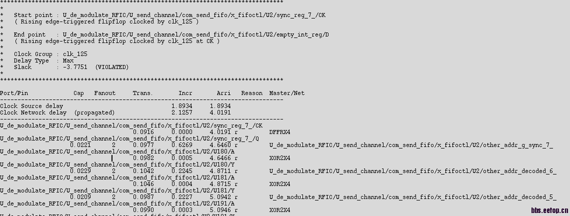

Clock Network delay  (propagated)  clock source delay
两者的区别?

说变描述一下,
clock source delay:约束的是输入时钟到你startpoint之间的延时。
Clock Network delay  :clkin 到clkout之间"clock source delay+ clock 走过的buffer"
多多交流!!!
发表于 2011-8-12 11:01:39 | 显示全部楼层
不对,
clock source delay 是到你定义的时钟的那个端口之前的时钟延迟,或者说源时钟本身的延迟
确切地英文解释为“Clock source latency is the time it takes for a clock signal to propagate from its actual ideal waveform origin point to the clock definition point in the design. ”
如果不涉及几个源时钟之间的关系,一般不用定义source delay
clock network latency 是从你定义的时钟的那个端口之后,到FF之间的延迟,也叫clock inserion delay

我在手册上看到Source latency, also known as insertion delay, is the time it
takes for a clock to be propagated from its ideal waveform origin point to the clock definition
那clock insertion delay也就是insertion delay的一部分啦?
