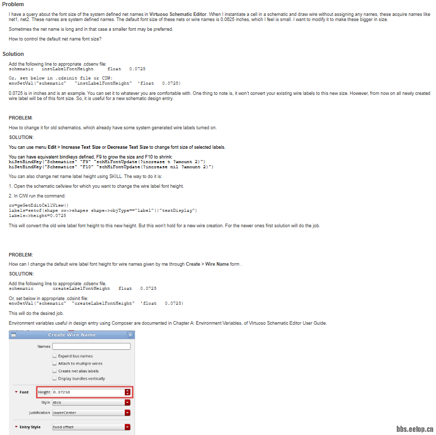

谁有cadence账户,麻烦帮看看这个链接里面的内容,谢谢
https://support1.cadence.com/public/docs/content/11000349.html
