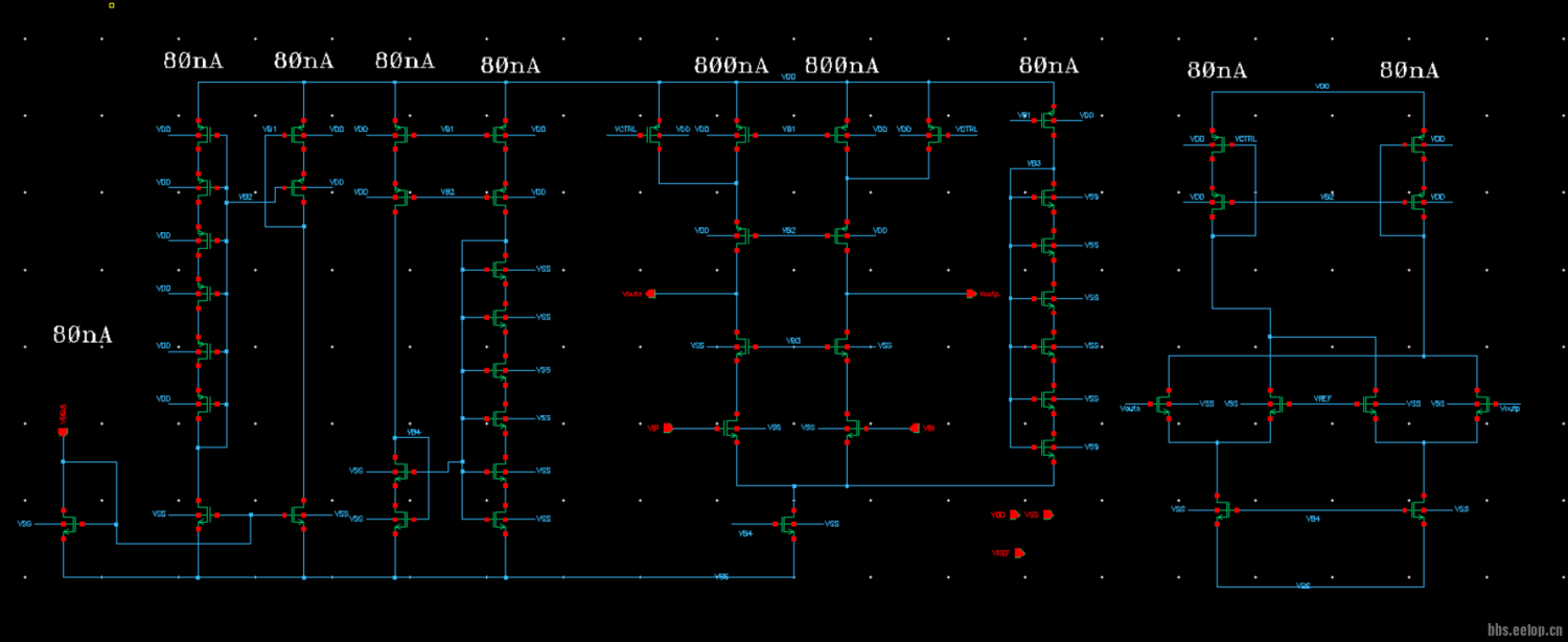

为什么到nA级电流的情况下,需要共模反馈才能让管子全部饱和,但是输出幅度就不对?

please could you give schematic as example
 楼主| 发表于 2025-11-15 14:24:15 | 显示全部楼层
thank you reply,this is example

I think at 80nA they can only be in subthreshold. The common mode circuit might be needed to bias correctly where the currents used are way too small to generate common mode reliably.
Hopefully somebody can answer this question.
