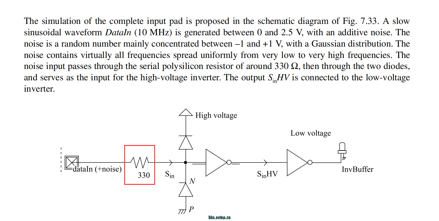

如图,想请问下这个电阻有何作用?

It is called as limiting resistor. By any means residue during ESD will not affect the gate of input stage.

发表于 2024-1-5 11:35:06 | 显示全部楼层
ESD电阻,注意下接触孔和宽度。
版图上也不同于普通电阻,要做特殊标识。
