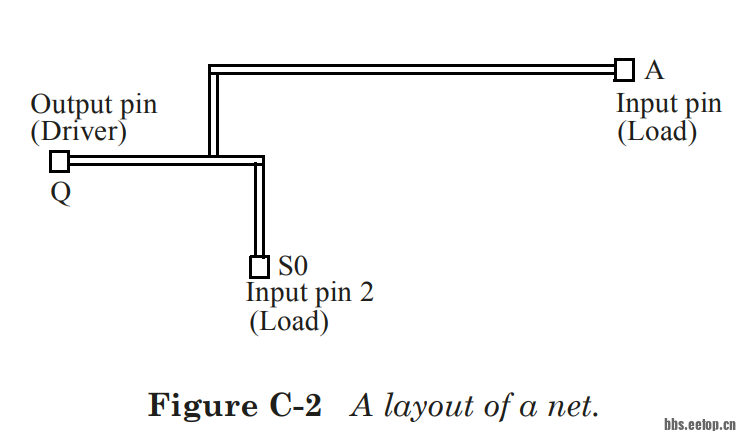

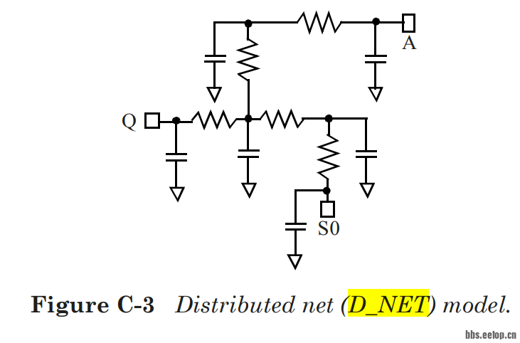

请问下各位大神 SPEF文件中的D_NET R_NET 的含义是什么呢?谢谢~
发表于 2025-9-18 16:43:15 | 显示全部楼层
SPEF supports the distributed net model, the reduced net model and the lumped capacitance model. In the distributed net model (D_NET), each segment of a net route has its own R and C. In a reduced net model (R_NET), only a single reduced R and C is considered on the load pins of the net and a pie model (C-R-C) is considered on the driver pin of the net. In a lumped capacitance model, only a single capacitance is specified for the entire net.
Figure C-2 physical net route

Figure C-3 distributed net model
