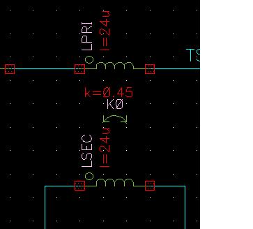

发表于 2014-1-4 16:07:16 | 显示全部楼层 |阅读模式
我在
http://bbs.eetop.cn/viewthread.php?tid=325241&highlight=%B1%E4%D1%B9%C6%F7%C4%A3%D0%CD
看到[size=1em]peterlin2010发的一篇关于变压器的Veriloga模型文件。
// VerilogA for edaboard, transformer, veriloga
`include "constants.vams"
`include "disciplines.vams"
module transformer(pr1,pr2,sec1,sec2,th1,th2);
inout pr1,pr2,sec1,sec2,th1,th2;
electrical pr1,pr2,sec1,sec2,th1,th2;
parameter real n1 = 1.0 from [1:inf); //number of turns in primary winding
parameter real n2 = 3.0 from [1:inf); //number of turns in second winding
parameter real n3 = 3.0 from [1:inf); //number of turnes in third winding
parameter real L = 1n from (0:inf); //inductanse per one turn in H
parameter real k12 = 0.97 from [0:1]; //coupling between first and second, first and third windings
parameter real R1 = 1.0 from [0:inf); //resistance of primary winding in Ohm
parameter real R2 = 3.0 from [0:inf); //resistance of second winding in Ohm
parameter real R3 = 3.0 from [0:inf); //resistance of third winding in Ohm
real k13,F1,F2,F3;
analog begin
@(initial_step or initial_step("dc")) begin
k13 = k12;
end
F1 = L*(n1*I(pr1,pr2)-k12*n2*I(sec1,sec2)-k13*n3*I(th1,th2)); //magnetic flow through primary winding
F2 = L*(n2*I(sec1,sec2)-k12*n1*I(pr1,pr2)+n3*I(th1,th2)); //magnetic flow through secondary winding
F3 = L*(n3*I(th1,th2)-k13*n1*I(pr1,pr2)+n2*I(sec1,sec2)); //magnetic flow through secondary winding
V(pr1,pr2)<+R1*I(pr1,pr2)+n1*ddt(F1);
V(sec1,sec2)<+R2*I(sec1,sec2)+n2*ddt(F2);
V(th1,th2)<+R3*I(th1,th2)+n3*ddt(F3);
end
endmodule
我仿真后波形都是正确的,可是根据原边电流上升的斜率来计算得到的原边电感(Lp=Vdc/k(k是原边电流上升的斜率))总很与模型中原本设置(Lp=L*n1(n1是原边的匝数,L是每一圈的电感量))的不相等。二者相差很大!
请问这是怎么回事?求教!谢谢了!
我的邮箱:2013xpc@gmail.com

回复 2# peterlin2010
    用cadence analogLib里面的ind+mind进行初级、次级耦合,可以很好模拟。同时也可以在初、次级上面加入寄生电阻、电容等等。

 楼主| 发表于 2014-1-9 15:29:06 | 显示全部楼层
回复 3# silverpuma
   可否具体说明一下反激式(flyback)变压器模型的建立,非常感谢啦!
发表于 2014-1-9 17:37:32 | 显示全部楼层
回复 5# gnehcb
用mind 耦合 两个电感即可,K取1,K表示耦合系数(实际上不可能为1,为了加快仿真速度)。电感量不一样就代表匝数不一样。一般初级线圈电感量可以通过系统方案计算出来,次级的就根据匝数填入就可以了。其他的寄生R或者C在电感两端加入即可。
发表于 2014-1-9 17:48:24 | 显示全部楼层
回复 4# peterlin2010
    变压器的参数得自己计算出来,然后填入模型即可,见本帖回复。
 楼主| 发表于 2014-1-9 17:55:15 | 显示全部楼层
回复 6# silverpuma
   非常感谢你的分享,我试一下,可能还有问题向你请教!麻烦啦!
 楼主| 发表于 2014-1-9 18:19:46 | 显示全部楼层
回复 6# silverpuma
   silverpuma:       真的很感谢你的分享,我试了一下,结果很理想,解决了我的一个大问题。谢谢啦!
