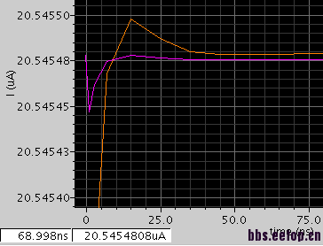

发表于 2013-10-22 09:05:18 | 显示全部楼层
when the circuit achieve stable state, the current passing the resistor R is 20uA.
at the initial state, Pmos mirror sources40uA, while the Nmos mirror can only sink 20uA, so there is a net sourcing 20uA current charging to the parasitic capacitors of P/Nmos drain region. finally, the voltage on the upper node of the resistor raises, and push the PMOS to the linear region a bit, and make the sourcing ability weaker till 20uA, and then the balance is achieved.

发表于 2013-10-22 10:06:01 | 显示全部楼层
俺仿了一下,最右PMOS确实没出现40A的情况。
红线为最右NMOS漏电流,黄线为最右PMOS源电流。

发表于 2013-10-22 13:17:50 | 显示全部楼层
只可能20uA多一点 而且 PMOS处于线性区
