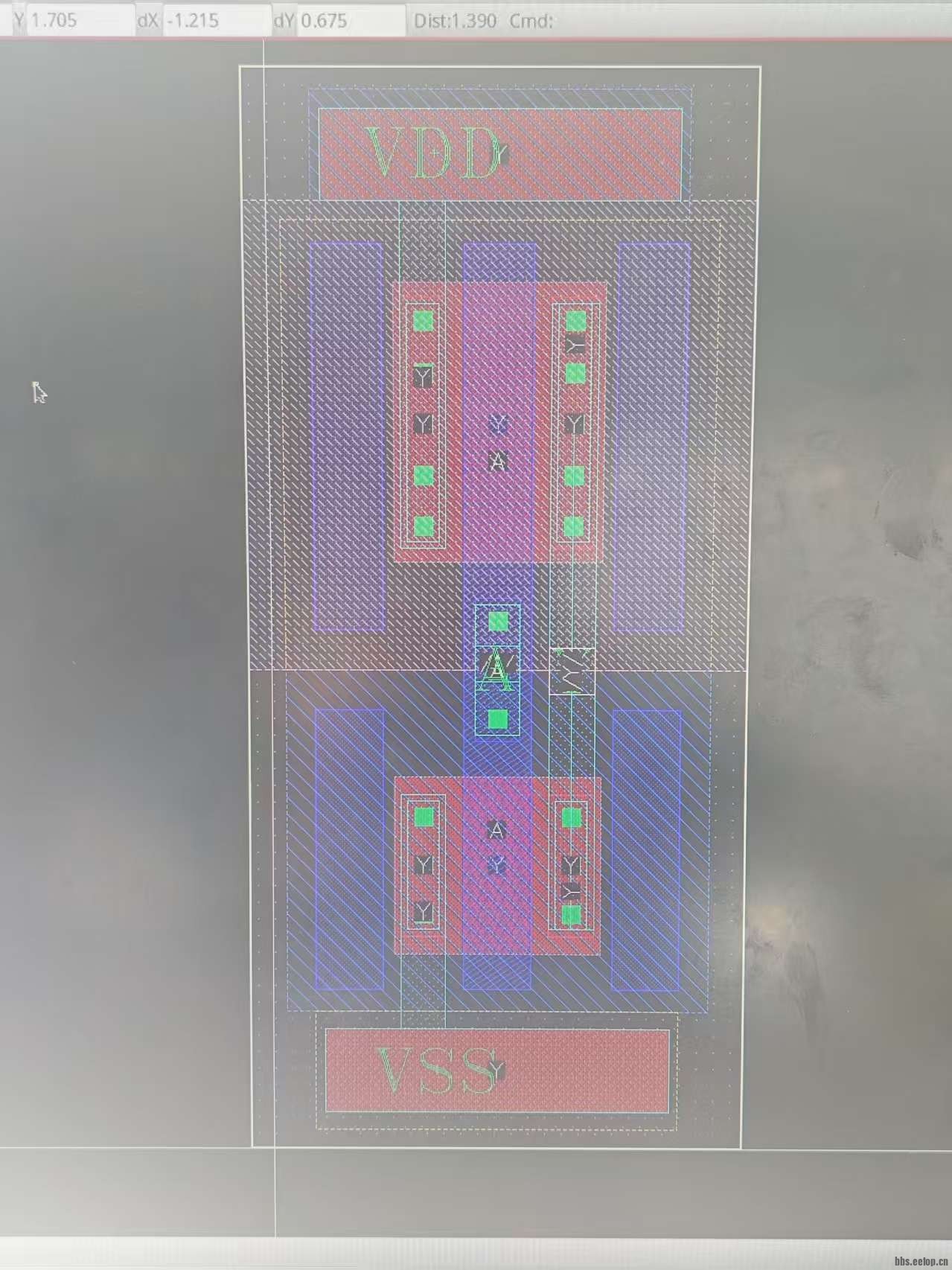

打开标准单元器件库时出现下面的WARNING
Constraint validlayers in constraint group virtuosoDefaultExtractorSetup of technology hlmc28hkcp contains an unimplanted diffusion layer AA but no p-implant layer. this incomplete setup can result in incorrect open markers. for accurate connectivity extraction,add a p-implant layer to the constraint.
Constraint validlayers in constraint group virtuosoDefaultExtractorSetup of technology hlmc28hkcp contains an unimplanted diffusion layer AA but no n-implant layer. this incomplete setup can result in incorrect open markers. for accurate connectivity extraction,add a n-implant layer to the constraint.
Constraint validlayers in constraint group virtuosoDefaultExtractorSetup of technology hlmc28hkcp contains a diffusion layer AA and a poly layer PO but no derived layer indicating that the diffusion layer is stopped by the poly layer. This incomplete setup can result in incorrect short markers.for accurate connectivity extraction,add an appropriate derived layer to the constrain.
而且用XL打开后,creat pin ‘Y’会导致下面的情况出现(短接),这是什么情况,怎么解决这个问题。

这个是版图短路的示意图

好像是这个工艺缺少一个隔开的层
发表于 7 小时前 | 显示全部楼层
warining information已经说的很清楚了。在tf文件中的constraint Groups中的virtuosoDefaultExtractorSetup中添加一些信息。如:implant layer connectivity,stop layer.如果不添加话,在run 一些XL command,如extract layout connectivity时,会有marker出现。这个marker的类型:诸如short,open。具体可看XL 第二章。
