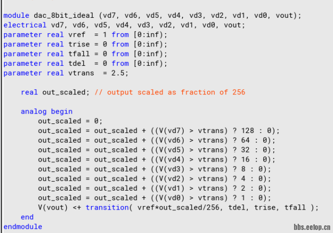

[求助] 有没有大佬用verilogA写过一个有时钟控制端的DAC
发表于 前天 21:15 | 显示全部楼层 |阅读模式
在ahdlib库里找到了理想的8位DAC,想加个时钟端。
发表于 前天 22:04 | 显示全部楼层
输入信号加触发器也行
发表于 昨天 00:27 | 显示全部楼层
You can make output signal be triggered only if CLK is positive/negative edge, by utilizing @(cross(CLK-0.5*Vdd,+1))
all output expressions should be enclosed in begin end block, that followed by @(‧) analog event monitor.
Alternative way will be adding 8 control-switch (ideal relay) to your 8-bit digital DAC inputs
