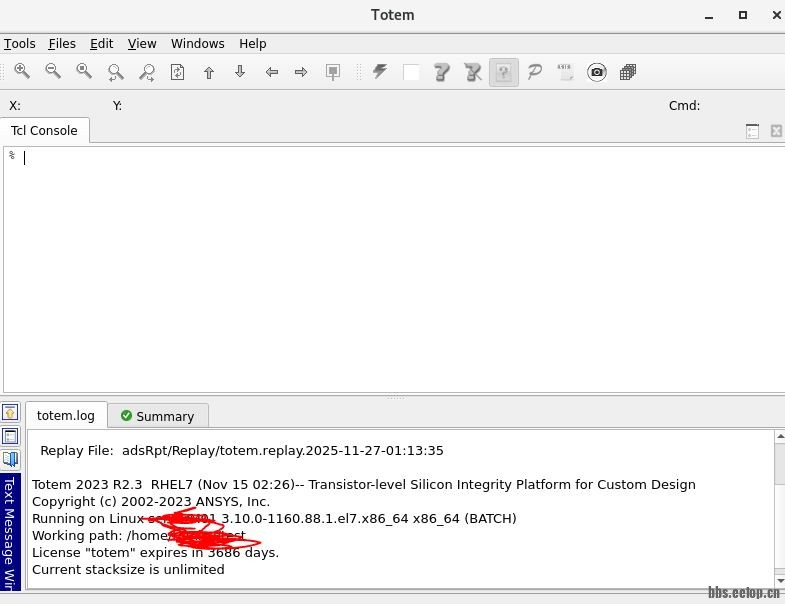

装完软件,patch完后
在正常 lmgrd -c license后,一切都正常
lmstat -c 状态一切正常。
.cshrc A 中是 写setenv APACHEDA_LICENSE_FILE  2055@@serverMa01,但是source .cshrc A后,怎么都起不来
报错 "ANSYS LICENSE MANAGER ERROR:Request name totem does not exist in the licensing pool.
License server machine is down or not responding.
See the system administrator about starting the license server system, or
make sure you're referring to the right hosERROR(LIC-001): License totem checkout failed.
然后,做了.cshrc B 写的是 setenv  APACHEDA_LICENSE_FILE /eda/ansys/license/license.dat
神奇的事情发生,source .cshrc B 后,就能正常启动,并且 license.log里还能有正常的check in out信息。。。
1:03:50 (ansyslmd) OUT: "redhawk_key" x@serverMa01  [7293]
1:03:50 (ansyslmd) IN: "redhawk_key" x@serverMa01  [7293]
1:03:50 (ansyslmd) OUT: "totem" x@serverMa01  [7293]
1:05:07 (ansyslmd) IN: "totem" x@serverMa01  [7293]
诡异的事情是, 两者缺一不可
如果不lmgrd -c ,即使source .cshrc B,软件也起不来
lmgrd -c  后,竟然不能用" setenv APACHEDA_LICENSE_FILE  2055@@serverMa01" 的.cshrc,
要用 “setenv  APACHEDA_LICENSE_FILE /eda/ansys/license/license.dat“ 的.cshrc
实在第一次遇到。
软件是”Totem_Linux64e7_V2023R2.3“
有大神指点迷津吗?
