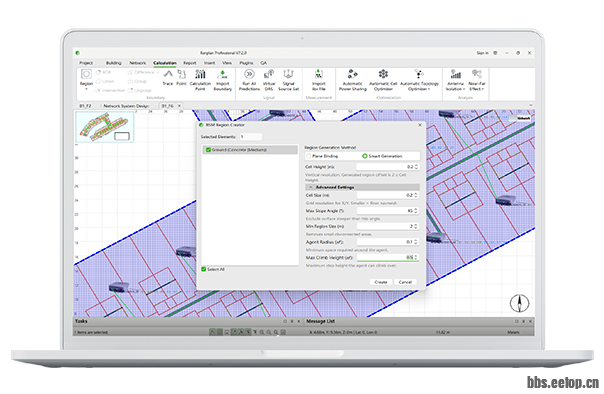

Simplified RF Calculation Region Generation
New tools reduce calculation setup time for irregular or multi-surface environments, such as tunnels, underground facilities, or industrial sites.
  • Orientation-Based Filtering: Automatically remove unwanted surfaces during region creation.
  • Colour-Coded Previews: Instantly visualize and verify surfaces before generation.
  • Z+ Axis Offset Control: Adjust region height for precise simulation coverage.
  • Smart Region Creation: Automatically generate accurate and efficient calculation regions for complex structures.
