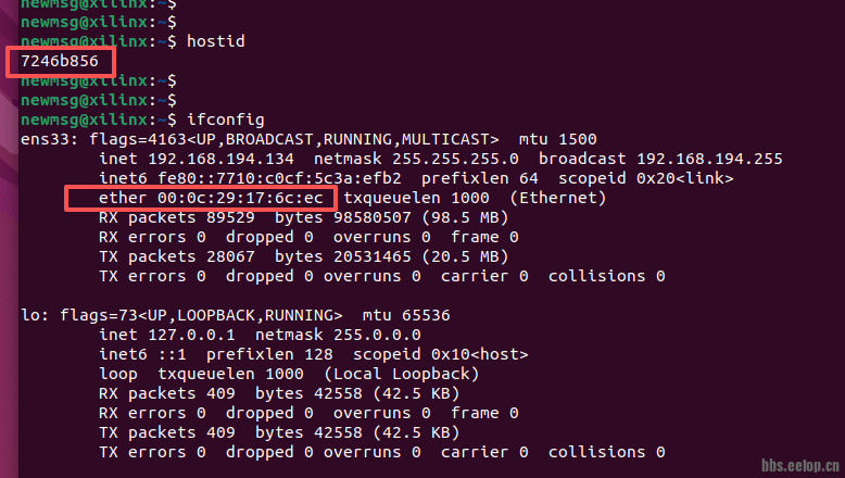

运行vsim 还是弹出license错误, 难道不支持questasim 2024.2? 最高只支持 2024.1?
请问这个hostid是什么? 是一串数字?
newmsg@xilinx:~$ hostid
7246b856
还是网卡mac_id?  00:0c:29:17:6c:ec  写成数字就是000c29176cec
多谢各位大佬指导.
发表于 2025-10-21 04:52:35 | 显示全部楼层
use lmhostid and it should return MAC address written as a number 000c29176cec
also set server host name correctly

非常感谢您的指导!解决了hostid的疑问, 已经可以正常工作了.  发表于 2025-10-21 09:27
 楼主| 发表于 2025-10-21 09:16:42 | 显示全部楼层
also set server host  ...
newmsg@xilinx:/opt$ /opt/synopsys/scl/2023.09/linux64/bin/lmhostid
lmhostid - Copyright (c) 1989-2023 Flexera. All Rights Reserved.
The FlexNet host ID of this machine is "000c29176cec"
 楼主| 发表于 2025-10-21 09:26:46 | 显示全部楼层
questasim 2024.2 on ubuntu 22.04 已经可以正常工作了,谢谢!
