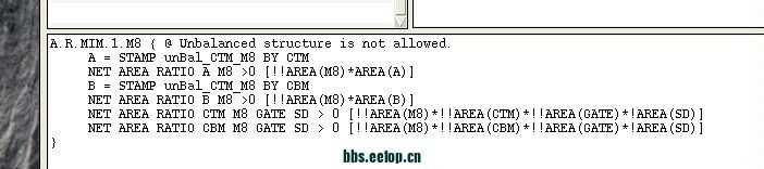

MIM电容报上述错误怎么解决?
登录/注册后可看大图
这句话后半句如何理解?
 楼主| 发表于 2022-12-10 14:08:12 | 显示全部楼层
“Balanced structures" define as below:
 楼主| 发表于 2022-12-10 14:10:43 | 显示全部楼层
Both CTM and CBM nodes are floating or connected to ground)including protection OD) through the same metal path (i.e. Mz, Mu or AP-MD) after MIM structure is formed.
