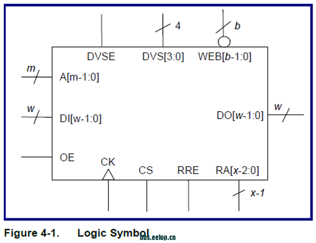

如图,请问各位大佬,以下几个pin的含义是什么?
01. RRE
02. DVSE/DVS
03. RA

dvs discharge option setting

rre redundency enable
ra redunduncy address
非常感谢!
