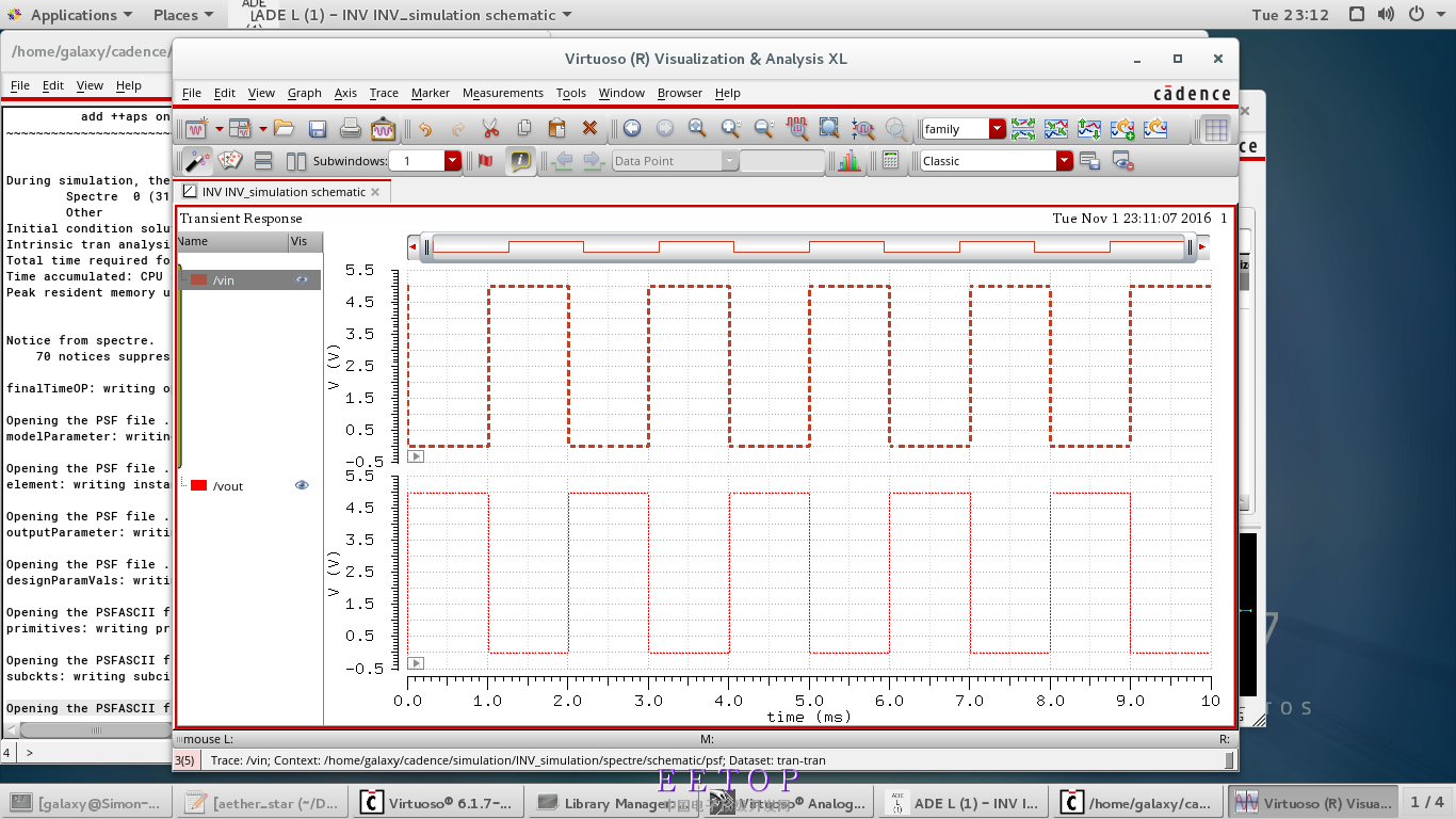

刚刚安装好IC617,画了个反向器准备测试一下软件,可是仿真后发现仿真波形是虚线,IC617都这样显示波形的吗?如下图!!! Screenshot from 2016-11-01 23-12-13.png

 楼主| 发表于 2017-6-24 23:19:25 | 显示全部楼层
最后还是自己解决了,点中波形图,右击,选择stly,再选择需要的画图方式就行

发表于 2020-10-23 14:58:35 | 显示全部楼层
难道每次都要改吗?
回复 支持 1 反对 0
发表于 2021-5-22 08:14:04 | 显示全部楼层
对啊,每次都改吗?
发表于 2021-10-19 15:55:54 | 显示全部楼层
http://bbs.eetop.cn/thread-896103-1-1.html 这里有解决方法
1. CIW 菜单  "Tools ->Display Resources Manager...“
2. Click "Edit..." in Display Resources Tool Box.
3. Change "Tech Lib Name" to your technology library.
4.select "All LPPs".
4. Search for layer "y0 drawing" and modify the Line Style and click "Apply" at the bottom of "Layers" column.
5. Re-do step 4 to change "y1", "y2" ........ "y9" drawing layers.
6. click "Modify Current Packet" on the rigth-down corner or File->Save in the Display Resource Editor.
7. Load this in your CIW with "drLoadDrf "./display.drf" command
after your pdk display.drf file is loaded.
For standalone ViVA environment variables should be set in the .cdsinit
or .cdsenv files, i.e.
• viva.trace lineStyle string "solid" nil
• viva.trace lineThickness string "thick" nil
A full list can be found in this file $CDSHOME/tools/dfII/etc/tools/viva/.cdsenv
发表于 2021-10-19 16:03:23 | 显示全部楼层
