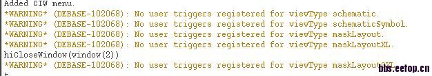

装IBM Bicmos 8HP库 出现这个问题 请问这是怎么回事 如何解决?
 楼主| 发表于 2011-11-17 16:09:52 | 显示全部楼层
我顶 貌似对使用没啥影响啊
发表于 2011-11-17 21:06:36 | 显示全部楼层
firstly, they are not errors,just a warning message, they should not have any effect on your jobs.
maybe what causes the messages is to call automatically the skill function 'deUnRegUserTrigger()' which will check if you set a bindkey for the PDK in your initial file, if not, just show the warning message, you can set the user bindkey in the .cdsinit, or by ibmPDKBindKey() in CIW, or just leave it untouched ,ignored the message.
