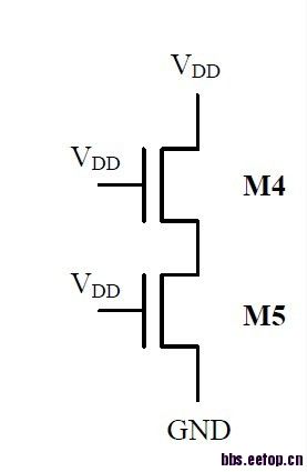

如图 怎么判断m两个mos管的工作区域?

work region should according to difference between D to G voltage whether is large or less than threshold voltage.

Once a current flows M4 and M5 and they have the same threshold voltage , M4 will be under saturation region and M5 will operate at triode region.
Because VGD4<VTH and VGD5>VTH.

    no,u are wrong, M4 is in saturation region and M5 is in linear region..

3楼,4楼的说的是一回事啊

饱和区就是夹断点,漏端电压高于栅端一个阈值
