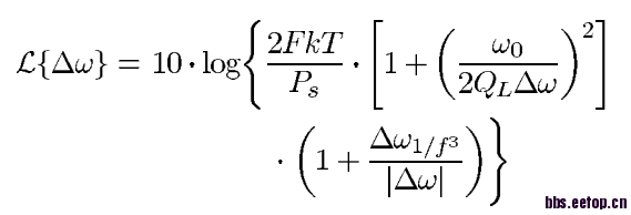

Leeson–Cutler phase noise model
QL is the effective quality factor of the tank with all the loadings in place (also known as loaded Q).
