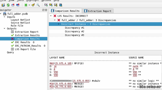

[求助] 求助:aether跑LVS报错
发表于 昨天 20:09 | 显示全部楼层 |阅读模式
具体报错如下:
LAYOUT NAME                                               SOURCE NAME
M40(25.975,4.105) MP(P18)                                 ** no similar instance **
D: 14                                                     ** net4 **
G: A                                                      ** A **
S: VDD                                                    ** VDD **
B: VDD                                                    ** VDD **
X100000000000044(25.975,0.055) #sdw2v                     ** no similar logic **
M18(25.975,0.055) MN(N18)                                 ** no similar instance **
M19(26.775,0.055) MN(N18)                                 ** no similar instance **
** no similar logic **                                 X200000000000055 #nand2v
** no similar instance **                                 XI1/MNM1 MN(N18)
** no similar instance **                                 XI1/MNM0 MN(N18)
** no similar instance **                                 XI1/MPM1 MP(P18)
** no similar instance **                                 XI1/MPM0 MP(P18)

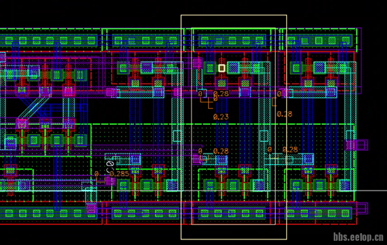

报错集中在该NAND,其他两个NAND和其他子模块无报错,连线没检查出问题,单个子模块过了DRC和LVS,整体也过了DRC。
