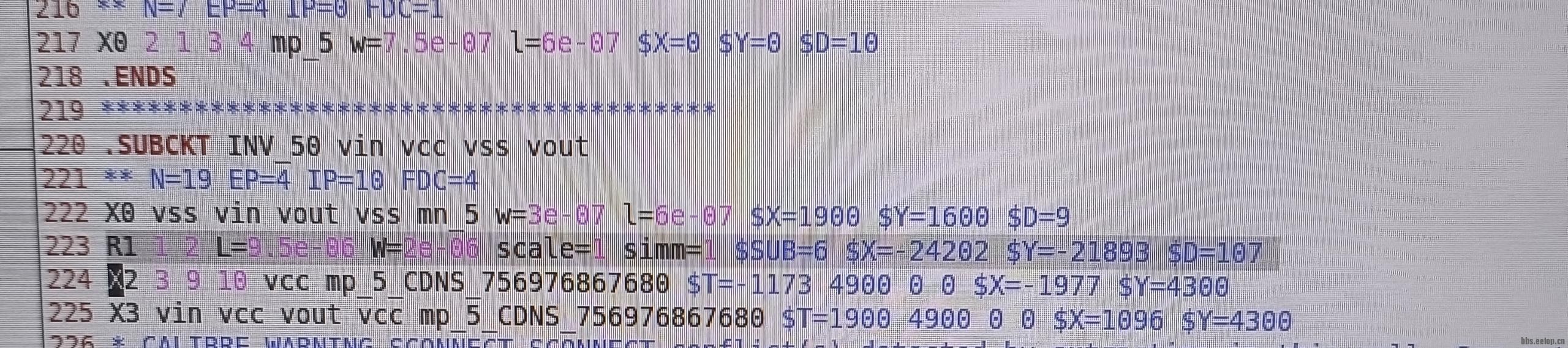

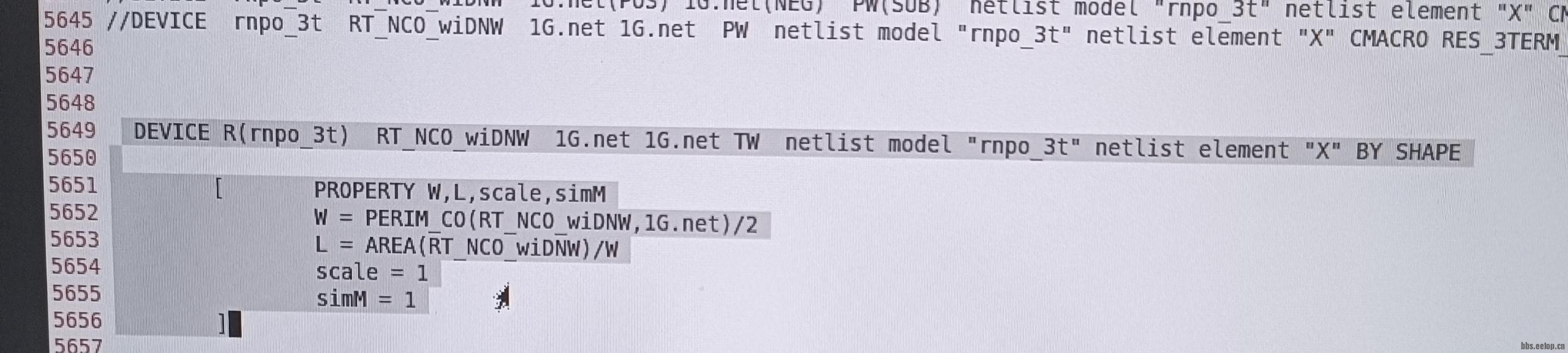

请问大家个问题,在lvs rule里面定义是有写R类型,但cell.sp抽不出来
3c8692d686243341adfa9586b743b42b_compress.jpg 463ee279c6ce615efc4f98170a5dcafa_compress.jpg
发表于 2025-9-5 10:00:05 | 显示全部楼层
应该是少了识别层,对应pcell查看下,
