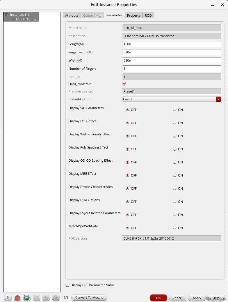

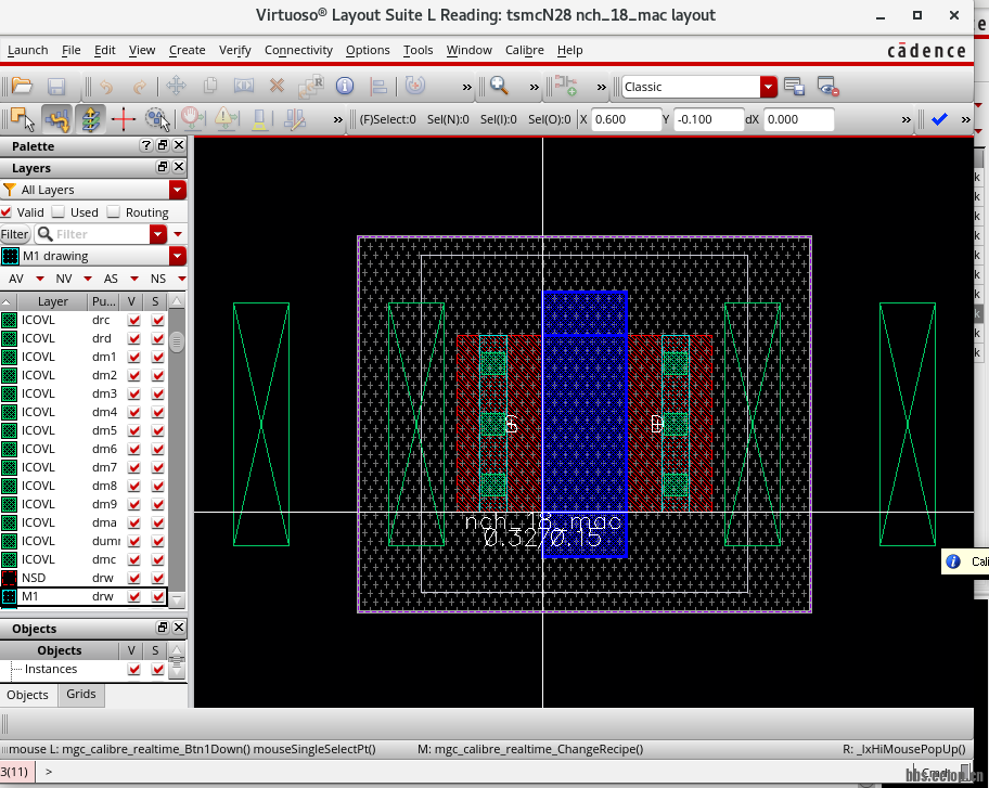

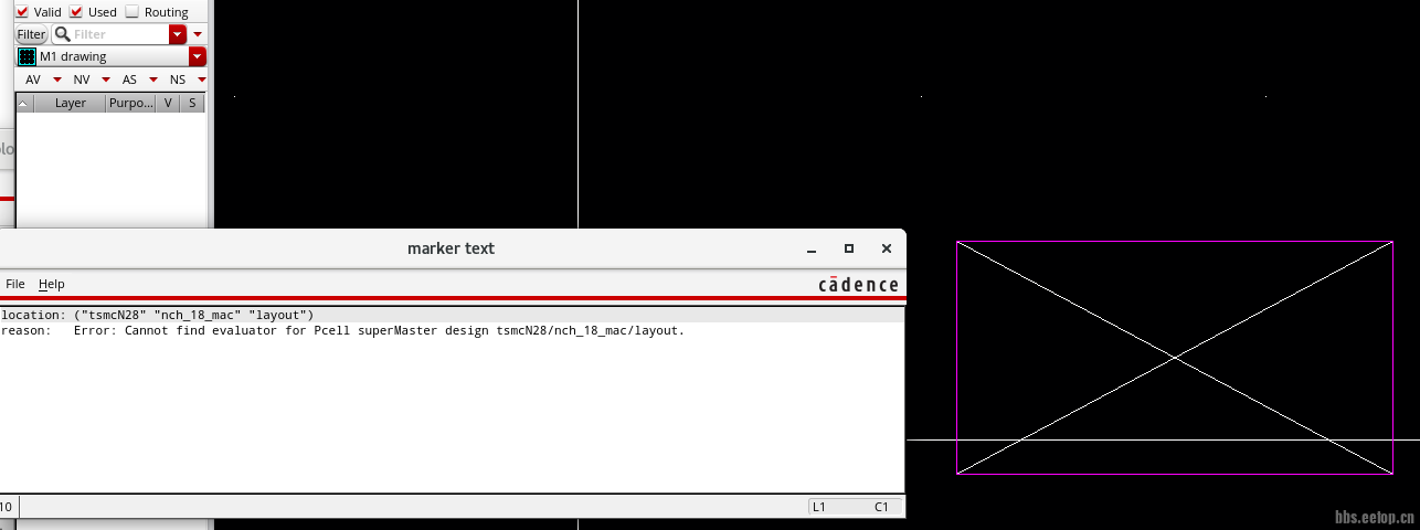

遇到的问题:在安装完TSMC28nm的工艺库之后,(例如)打开nch_18_mac cell中的layout view,可以正常看到mos管版图,但是insert nch_18_mac layout view使用的时候,显示一个白色的框框,q这个框框可以看到parameter参数,报error:Cannot find ecaluator for Pcell superMaster design tsmcN28/nch_18_mac/layout,尝试过attach工艺库,没有作用,请问有大佬知道原因吗?
nch_18_mac parameter参数
error
error

at the installing process, you had to choose options like below. 1) Cadence Only (PCell) 2) Synopsys,Mentor Graphics (PyCell) did you select 2? in my case i was the same case with you, so install again with (1) option. then it was solved.
发表于 2025-7-20 17:12:56 | 显示全部楼层
did you select 2?
then it was solved.
回复
 楼主| 发表于 2025-7-21 22:12:59 | 显示全部楼层
已解决
