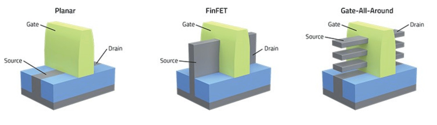

There are several types of GAA architectures in R&D, although vendors are focusing on one version, dubbed nanosheet FETs. Basically, a nanosheet FET is a finFET on its side with a gate wrapped around it, enabling higher performance chips at lower power.
Fig. 1: Planar transistors vs. finFETs vs. gate-all-around Source: Lam Research
“GAA technology is critical for the continued scaling of the transistor. A key characteristic of 3nm GAA is threshold voltage, which can be 0.3V. This enables significantly better switching with lower standby power compared to 3nm finFETs,” said Handel Jones, CEO of IBS. “Product design costs for 3nm GAA should not be significantly different from 3nm finFETs. But the key challenge is IP qualification for GAA, which will cost 1.5 times what it costs for a 3nm finFET.”

At the leading edge, though, there are several hurdles that need to be overcome. FinFETs approach their practical limit when the fin width reaches 5nm, which equates to the 3nm node. The contacted poly pitch (CPP) for finFETs reaches the limit around 45nm with a metal pitch at 22nm. The CPP measures from one transistor’s gate contact to the gate contact on the adjacent device.
Once finFETs run out of steam, chipmakers will migrate to nanosheet FETs at 3nm/2nm and perhaps beyond. FinFETs are still viable for chips from 16nm/14nm to 3nm, while planar transistors will remain the mainstream technology at 22nm and above.
Gate-all-around is different than finFETs. “Gate-all-around, or GAA transistors, are a modified transistor structure where the gate contacts the channel from all sides and enables continued scaling,” Lam’s Draeger explained. “Early GAA devices will use vertically-stacked nanosheets. They are constructed of separate horizontal sheets, surrounded by gate materials on all sides. This provides improved channel control relative to finFETs.”
In nanosheet FETs, each tiny sheet makes up a channel. The first nanosheet FETs will incorporate silicon-based channel materials for both pFET and nFET devices. Second-generation nanosheets likely will use high-mobility materials for pFET, while nFET will continue to use silicon.
A nanosheet FET consists of two or more sheets. Recently, Leti demonstrated a nanosheet FET with seven sheets. A seven-sheet GAA has a “3X improvement over the usual 2-level stacked nanosheet GAA transistors,” said Sylvain Barraud, a senior integration engineer at Leti, in a paper.
On the surface, the scaling benefits between 3nm finFETs and nanosheets appear to be minimal. Initially, a nanosheet FET could have a 44nm CPP with a 12nm gate length.
But nanosheets have several advantages over finFETs. With finFETs, the width of the device is quantized. In nanosheets, though, IC vendors have the ability to vary the widths of the sheets in the transistor. For example, a nanosheet with a wider sheet provides more drive current and performance. A narrow nanosheet has less drive current, but takes up a smaller area.
“GAA architectures improve the short-channel control for further gate length scaling and stacked nanosheets improve drive strength per footprint,” said Sri Samavedam, senior vice president of CMOS technologies at Imec, in a paper.

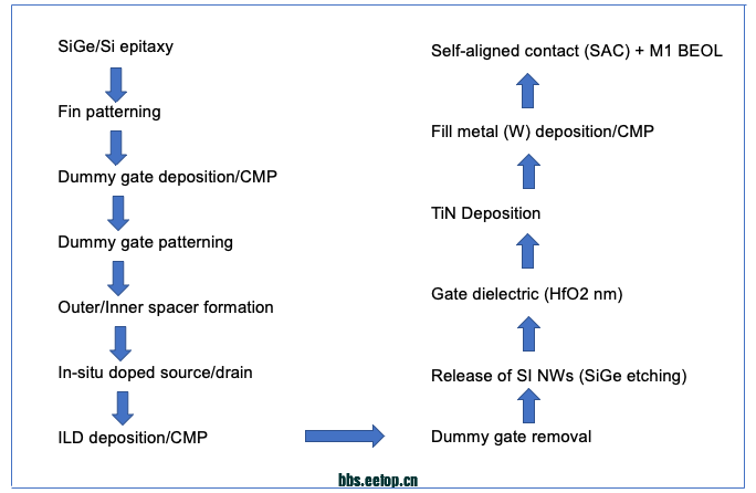

Fig. 2: Process flow for stacked nanosheet FETs. Source: Leti/Semiconductor Engineering
In a process flow, a nanosheet FET starts with the formation of a super-lattice structure on a substrate. An epitaxial tool deposits alternating layers of SiGe and silicon on the substrate. At a minimum, a stack would consist of three layers of SiGe and three layers of silicon.
The next step is to develop tiny vertical fins in the super-lattice structure. Each fin is separate with a space in-between them. In the fab flow, the fins are patterned using extreme ultraviolet (EUV) lithography, followed by an etch process.
“A GAA transistor is only as good as its weakest channel, thereby requiring individual nanosheet dimensional control metrology,” said Scott Hoover, senior director of strategic product marketing at Onto Innovation. “Fin formation through a super-lattice requires individual layer control for thickness, composition, and silicon sheet CDs.”
Then comes one of the harder steps — the formation of the inner spacers. First, the outer portions of SiGe layers in the super-lattice structure are recessed using a lateral etch process. This creates small spaces, which are filled with dielectric materials.
“Controlling process variation for the inner spacer recess etch is very difficult because there is no etch stop,” said Robert Clark, senior member of the technical staff at TEL. “Ideally, you are trying to recess the sacrificial epi between the nanowires only where it passes through the sidewall spacers, and then replace that epi layer with a dielectric inner spacer. It’s a critical ~5nm recess etch with no line of sight and no etch stop. That’s the process equivalent of a tightrope walk with no net.”
There are other challenges. “The inner spacer module is critical for the definition of key final transistor features and control of this module is critical to minimize transistor variability. The inner spacer module provides control of the effective gate length and also isolates the gate from the source/drain epi,” said Andrew Cross, process control solutions director at KLA. “During this module, the SiGe is indented, then inner spacers are deposited and recessed. At each of these steps in the inner spacer formation, precise control of the shape and CD of the indents and final spacer recess is critical to ensure correct device performance. Moreover, control is required for each individual channel in the stack.”
Then, the source/drain are formed, followed by the channel release process. For this, the SiGe layers in the super-lattice structure are removed using an etch process. What’s left are silicon-based layers or sheets, which make up the channels.
“This step is where the GAA structures are separated from each other, which can lead to challenging buried defect types, such as residues between nanosheets, damage to the nanosheets, or selective damage to source/drain regions adjacent to the nanosheets themselves,” Cross said.
There are even more challenges. “Channel release requires individual control of sheet height, corner erosion, and channel bending,” Onto’s Hoover said.
High-k/metal-gate materials are deposited in the structure. And finally, the copper interconnects are formed, resulting in a nanosheet FET. “The other modules that may change are the bottom isolation of the device and the workfunction metal/layers to accommodate the nanosheets, but those rely mainly on processes that were already known/developed in the industry and aren’t considered to be as difficult as the inner spacer formation. Of course, even the modules that aren’t new or changing radically continue to get more and more difficult as devices scale,” TEL’s Clark said.
