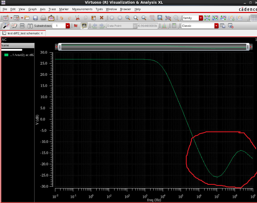

请问图中红圈的波形 1.是什么现象?有什么不利影响?2.一般由什么原因导致,应该怎么解决?求助,谢谢!

零点

You have to show the phase plot at the same time. The magnitude plot may indicate it's due to zeros but it looks like you have at leat TWO zeros @ 10MHz. Do you expect two zeros followed by a dominant pole in your topology?
