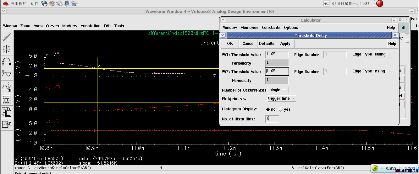

这是一个环振不同结点的波形,我要算两个波形的延迟时间,但是用计算器算的245p和我直接量出来的299p为什么不一样呢,是我计算器用的不对吗?
发表于 2012-4-9 13:46:00 | 显示全部楼层
I guess that your calculator calculated the delay of the first edges while your waveform measurement was done at the N-th edges.
 楼主| 发表于 2012-4-9 15:29:58 | 显示全部楼层
回复 2# lakeoffire
    So it is,Thank you very much!
