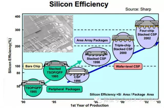

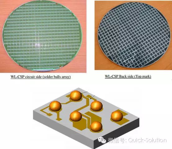

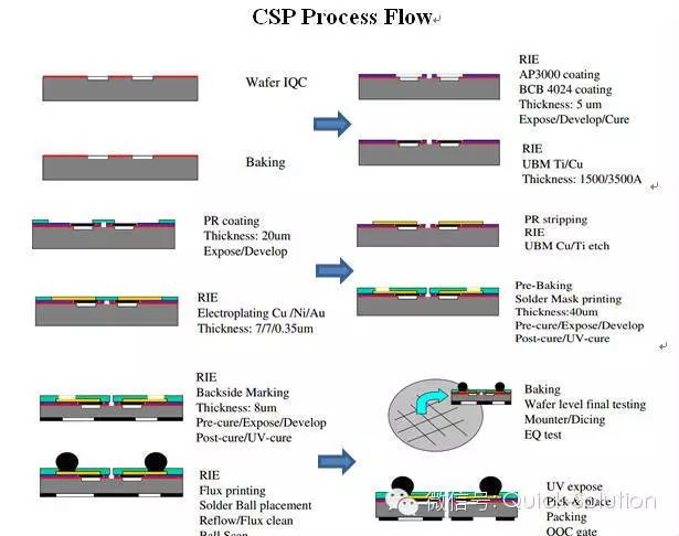

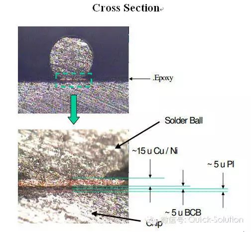

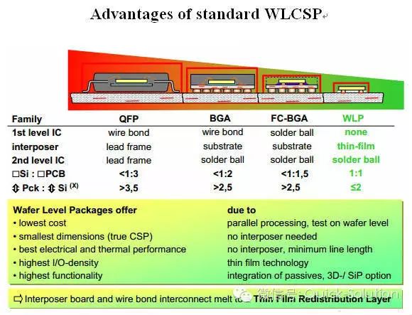

What WLCSP Is ?
1. Definition
2. Application
3. Evolution of packaging
4. Advantages of standard WLCSP
5. Structure
6. Cross Section
7. WLCSP Process Flow
8. CSP Process Spec
9. Reliability
