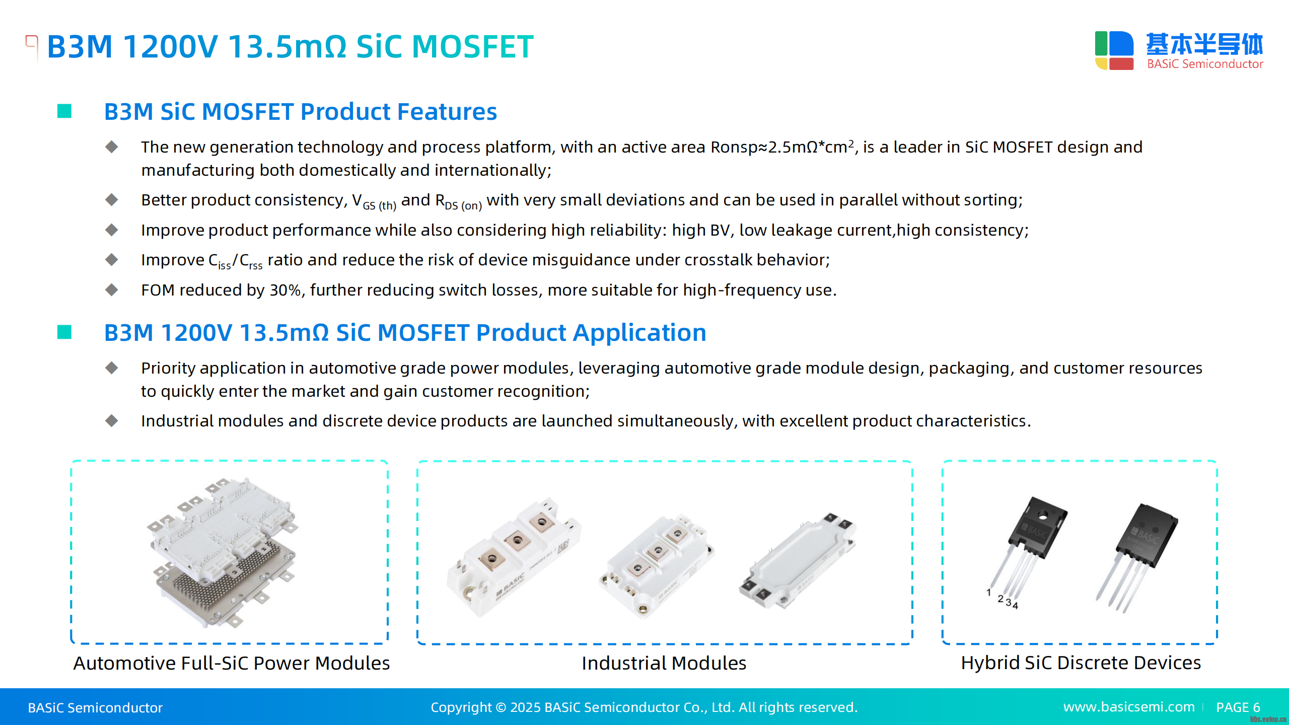

3.1. SiC MOSFETs: The Workhorse of High-Power Applications
BASiC's SiC MOSFET lineup is spearheaded by its B3M and B2M series, which are built on a new generation of chip technology and process platforms. These devices are designed to deliver exceptional performance and consistency. A key feature of the B3M series is its industry-leading active area manufacturing density, which translates to superior on-state resistance and efficiency. Furthermore, the B3M products are designed with remarkable consistency, exhibiting very small deviations in key parameters like gate-source threshold voltage,
VGS(th)​, and on-resistance, RDS(on)​. This consistency is crucial for high-power systems, as it allows for the paralleling of devices without the need for time-consuming sorting, which simplifies and accelerates manufacturing processes for the end user.
The B3M series also features an improved capacitance ratio (Ciss​/Coss​) which reduces the risk of unintended turn-on events, a critical consideration for device reliability and system stability. A lower Figure of Merit (FOM) further minimizes switching losses, making these devices exceptionally well-suited for high-frequency applications like photovoltaic inverters and AI server power supplies.

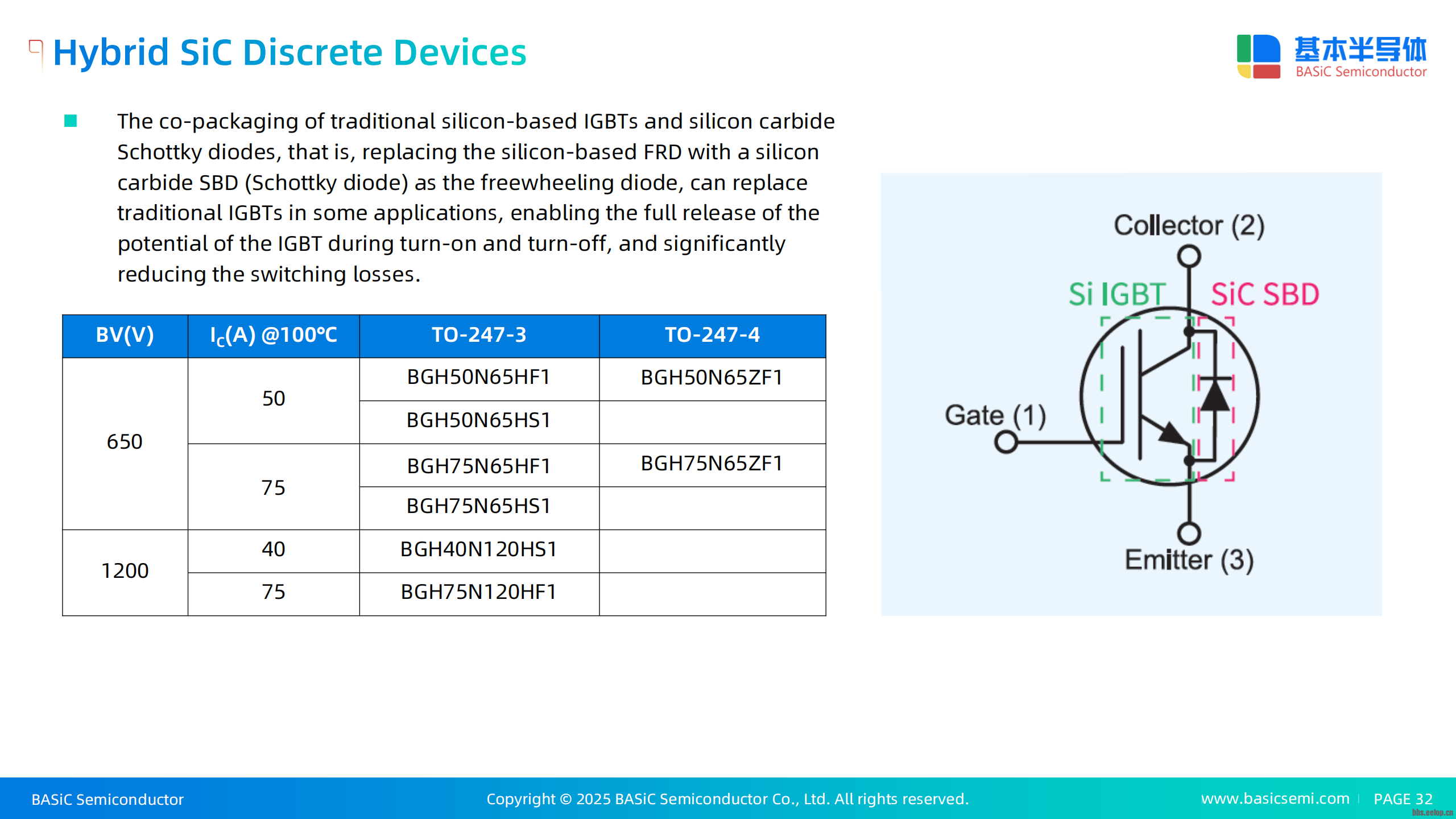

3.3. Hybrid SiC Devices: Balancing Performance and Cost
For applications that require a balance of high-performance and cost-effectiveness, BASiC Semiconductor offers its BGH series of Hybrid SiC devices. These devices innovatively co-package a traditional silicon-based Insulated Gate Bipolar Transistor (IGBT) with a SiC SBD, replacing the conventional silicon-based Fast Recovery Diode (FRD). This strategic combination addresses one of the primary limitations of IGBTs: their switching losses. By using a SiC SBD as the freewheeling diode, the IGBT's potential can be fully realized, with a significant reduction in total switching losses. This solution is particularly attractive for applications that require the robust current handling capabilities of an IGBT but can still benefit from the efficiency gains of SiC diodes, making it a powerful bridge technology for the power electronics market.

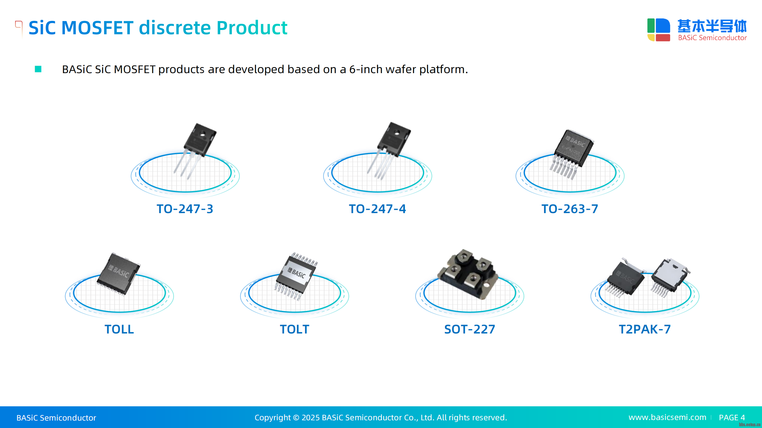

4.1. SiC MOSFET Product Table
The SiC MOSFET product portfolio from BASIC Semiconductor is extensive, covering a wide range of packages and specifications to meet diverse application requirements. The table below consolidates the key models, their voltage and on-resistance ratings, and available packages, including the new TOLL and TOLT form factors that offer low stray noise and enhanced thermal management.
wKgZPGixqQSAb-AJAAboz4M5hSk738.png wKgZPGixqQSAb-AJAAboz4M5hSk738.png wKgZO2ixqRmAG2S5AAisOwCGCzQ856.png
Table 1: BASIC Semiconductor SiC MOSFET Portfolio

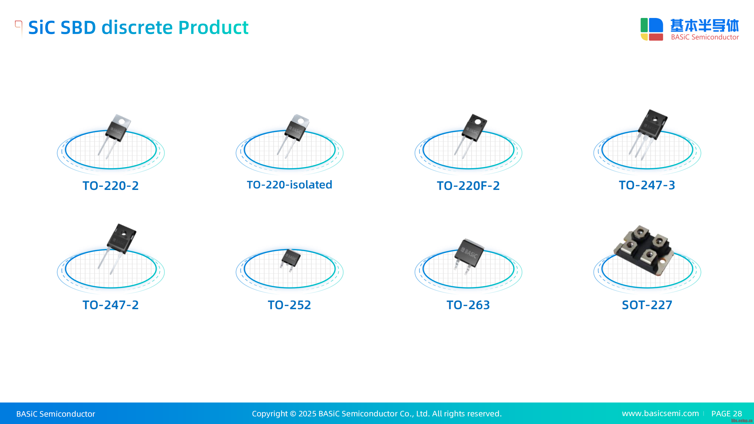

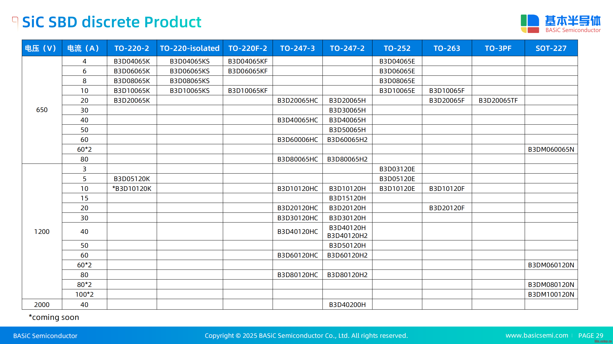

4.2. SiC SBD Product Table
SiC SBDs are essential components for improving the efficiency of power systems by eliminating the reverse recovery charge that plagues traditional silicon diodes. The table below provides an overview of the B3D series, showing the wide range of current and voltage ratings available in various packages.
Table 2: BASIC Semiconductor SiC SBD Portfolio
Voltage (V)Current (A)TO-220-2TO-220-isolatedTO-220F-2TO-247-3TO-247-2TO-252TO-263TO-3PFSOT-227
6504B3D04065KB3D04065KSB3D04065KF B3D04065E
6506B3D06065KB3D06065KSB3D06065KF B3D06065E
6508B3D08065KB3D08065KS  B3D08065E
65010B3D10065KB3D10065KSB3D10065KFB3D10065EB3D10065F
65020B3D20065K  B3D20065HCB3D20065HB3D20065F B3D20065TF
65030   B3D30065H
65040   B3D40065HCB3D40065H
65050   B3D50065H
65060   B3D60006HCB3D60065H2
65060*2        B3DM060065N
65080   B3D80065HCB3D80065H2
12003    B3D03120E
12005B3D05120K   B3D05120E
120010*B3D10120K  B3D10120HCB3D10120H B3D10120EB3D10120F
120015   B3D15120H
120020   B3D20120HCB3D20120H B3D20120F
120030   B3D30120HCB3D30120H
120040   B3D40120HCB3D40120H, B3D40120H2
120050   B3D50120H
120060   B3D60120HCB3D60120H2
120060*2        B3DM060120N
120080   B3D80120HCB3D80120H2
120080*2        B3DM080120N
1200100*2        B3DM100120N
200040   B3D40200H     Export to Sheets
Note: Models with an asterisk () are listed as "coming soon." *
4.3. Hybrid SiC Product Table
BASIC Semiconductor's Hybrid SiC devices offer a compelling "best-of-both-worlds" solution by combining the robustness of an IGBT with the efficiency of a SiC SBD. This family of products is ideal for applications where balancing cost and performance is paramount.
Table 3: BASIC Semiconductor Hybrid SiC Portfolio wKgZO2ixqViACietAAU-Saa4Llk933.png wKgZO2ixqUqAfSLBAAL4O4-9uJk066.png Voltage (V)Current (A)TO-247-3TO-247-4
65050BGH50N65HF1, BGH50N65HS1BGH50N65ZF1
65075BGH75N65HF1, BGH75N65HS1BGH75N65ZF1
120040BGH40N120HS1
120075BGH75N120HF1 Export to Sheets

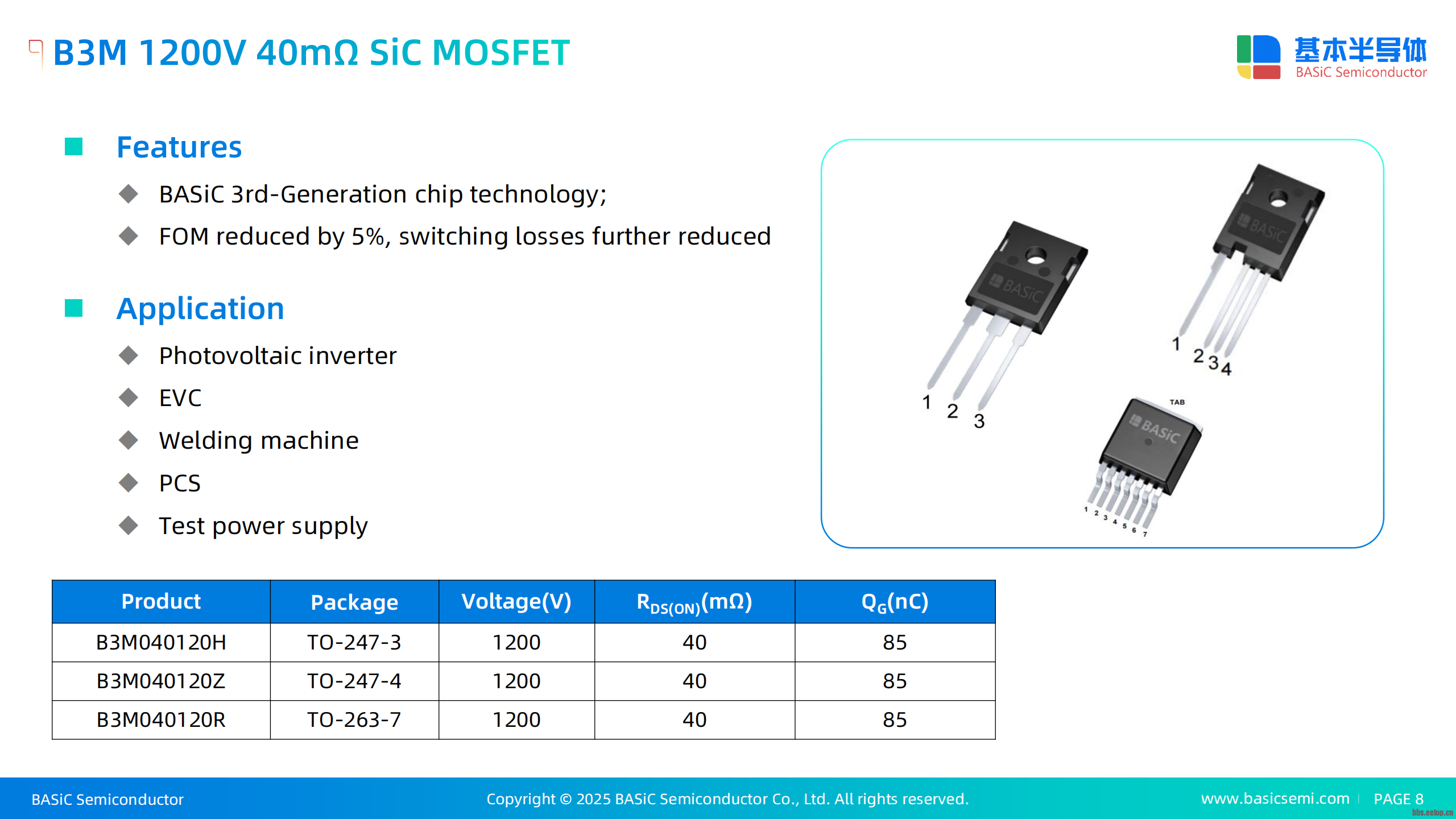

A direct comparison of the 1200V 40mΩ SiC MOSFET (B3M040120Z) against its contemporaries reveals its performance aligns with a strategy of predictable, robust operation across a wide temperature range.
Table 4: 1200V 40mΩ SiC MOSFET Competitive Analysis
ParameterUNITBASIC (B3M040120Z)CREEInfineononsemiSTMicroelectronicsROHM
Technology PlanarPlanarTrenchPlanarPlanarTrench
Generation G3G3M1HM3SG3G4
RDS(on)​ (Tj​=25∘C)mΩ404039404040
RDS(on)​ (Tj​=175∘C)mΩ706877807078
VGS(th)​ (Tj​=25∘C)V2.72.74.22.93.14
QG​nC9099397556107
FOM (Tj​=25∘C)mΩ⋅nC340039601521300022404280Export to Sheets
Data from.
The table above illustrates a crucial distinction in device architecture. While some competitors, such as Infineon and ROHM, employ a trench process that results in a lower Figure of Merit (FOM), this design choice comes with significant trade-offs. A critical observation is the rapid increase in the on-resistance (
RDS(on)​) of trench-based devices at high temperatures, which can nearly double from room temperature values. This rapid rise reduces their rated current and compromises performance at elevated temperatures, which are common in real-world applications.
In contrast, BASIC's B3M series, developed with a planar process, is positioned as a provider of stable and predictable performance. The on-resistance of the B3M040120Z device increases by a manageable 75% from 25°C to 175°C, ensuring consistent and reliable operation across the entire thermal range. This is a powerful selling point for risk-averse customers in mission-critical applications where thermal stability and performance predictability are paramount. The focus is not on winning a single metric but on providing a reliable, balanced, and robust solution that performs consistently in real-world scenarios.

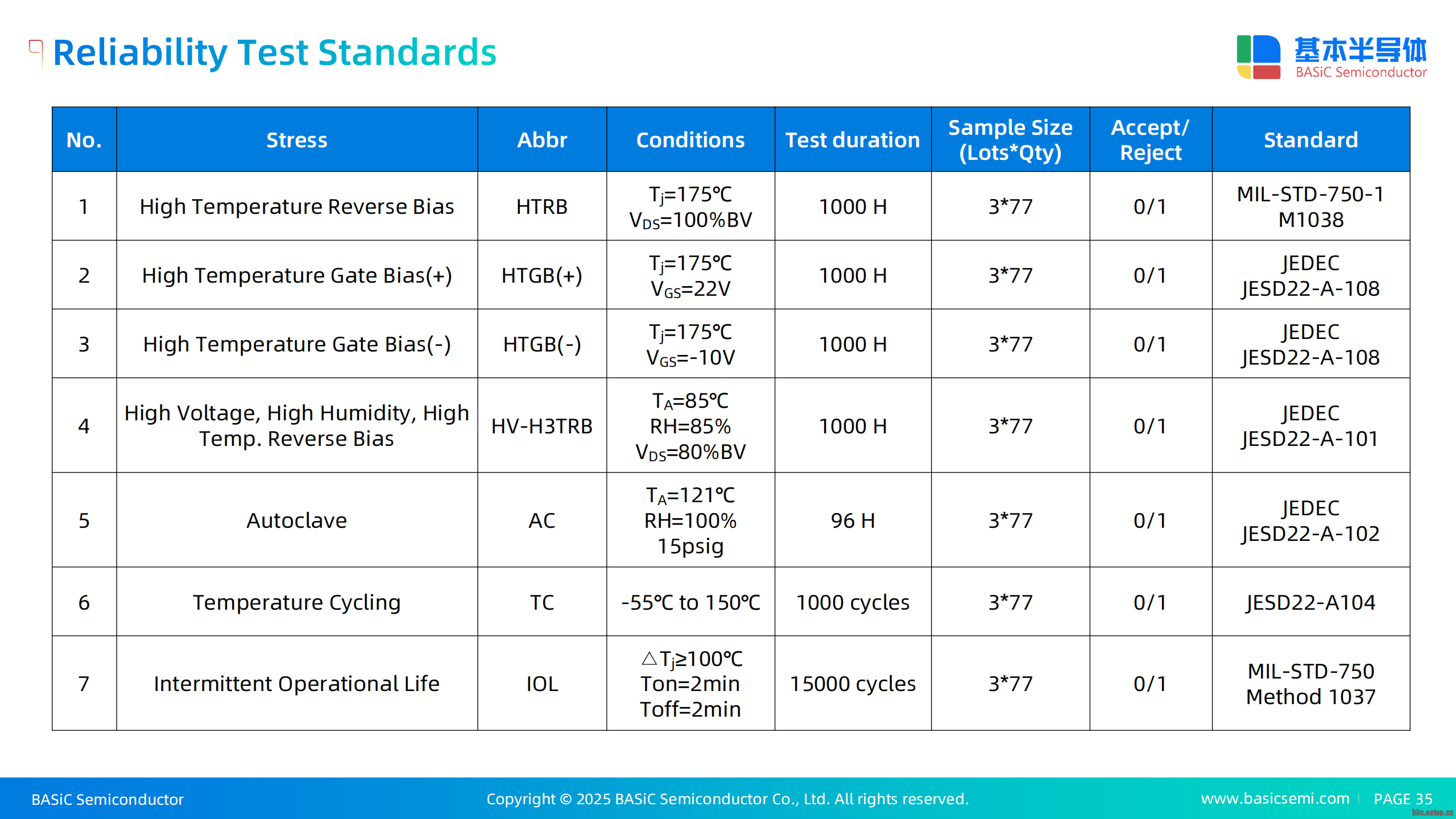

6.1. Exceeding Industry Standards with HTRB & H3TRB Testing
BASIC's products are compliant with the stringent AEC-Q101 and PPAP standards for automotive-grade products, a testament to their robust design and manufacturing processes. To validate long-term durability, the company subjects its devices to a suite of high-stress tests, including High Temperature Reverse Bias (HTRB) and High Voltage, High Humidity, High Temperature Reverse Bias (HV-H3TRB).
In a verification study, BASIC's devices successfully passed 2,500 hours of HTRB and H3TRB stress testing at voltages of 1320V and 1200V, respectively. This test duration is equivalent to more than four times the standard stress time, providing an exceptional level of assurance. The results showed that critical parameters, including gate-source threshold voltage (
Vgs(th)​), off-state leakage current (Idss​), and on-resistance (RDS(on)​), exhibited a controlled drift of less than 5%. This proven parametric stability is invaluable for customers designing systems with a 15- to 25-year service life, as it directly reduces the risk of long-term failure and ensures predictable performance throughout the system's operational lifetime.
6.2. The TDDB Test: Predicting Lifespan with Confidence
One of the most powerful proofs of BASIC's quality is its Time Dependent Dielectric Breakdown (TDDB) test results. This test goes beyond conventional reliability standards by probing the intrinsic failure mechanism of the gate oxide layer under extreme voltage stress. By applying constant, high gate voltages, the test measures the time it takes for the gate oxide to break down, thereby providing a basis for predicting the device's operational lifespan.
The results are compelling and provide an unprecedented level of confidence in the device’s long-term durability. The TDDB analysis demonstrates that BASIC's SiC MOSFETs can operate at a gate-source voltage (VGS​) of 20V for more than 108 hours (over 11,000 years) without an intrinsic failure. While these extrapolated numbers serve as a powerful illustration, their true significance lies in the underlying data. The fact that the devices can withstand over 3,000 hours of continuous high-stress conditions with minimal gate-source threshold voltage drift demonstrates a fundamentally robust gate oxide structure. This is not merely a technical achievement; it is a profound commercial differentiator that allows Changer-Tech to offer a tangible, data-backed reliability argument that few, if any, competitors can match.

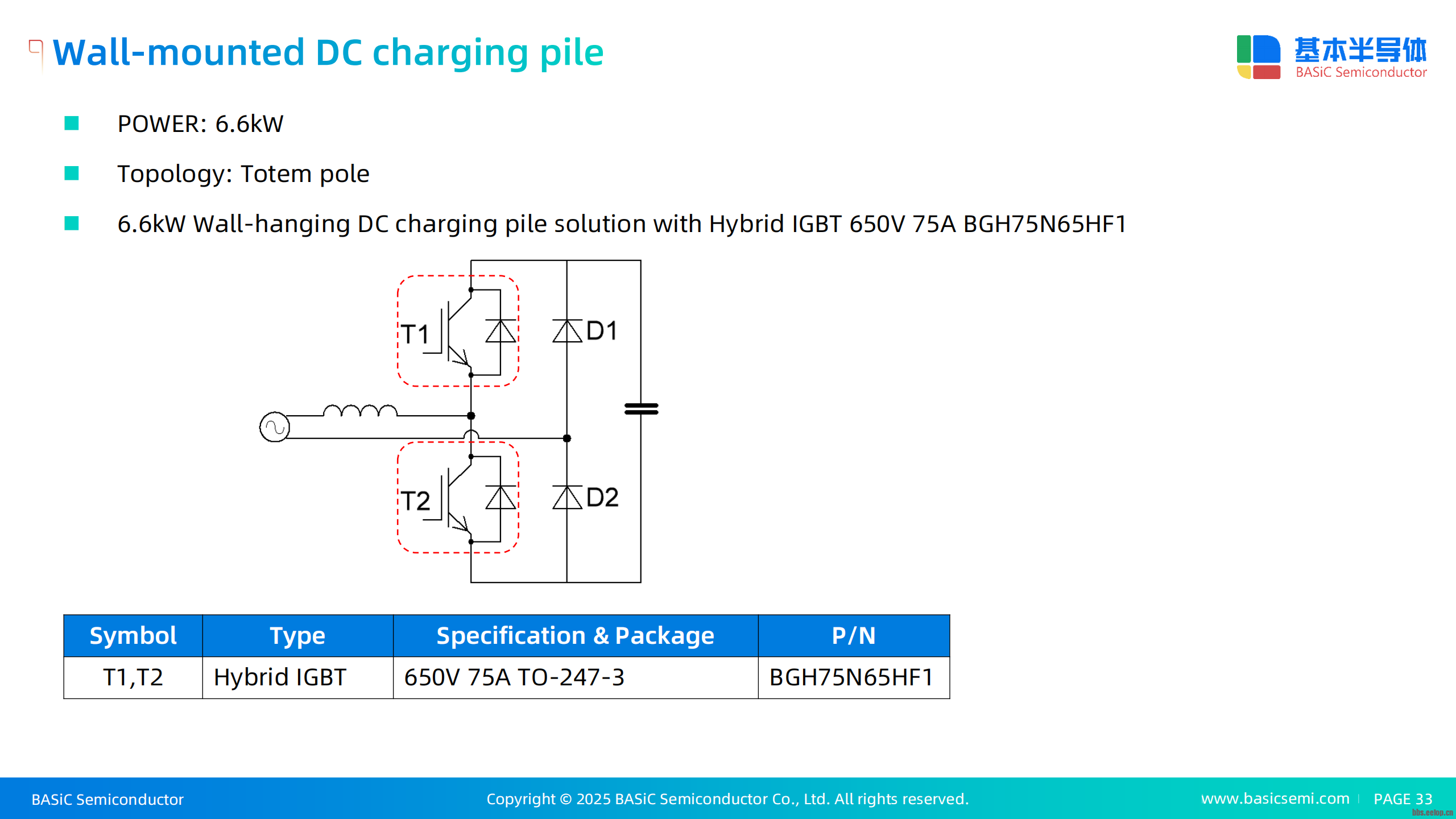

E-Mobility
DC Charging Pile (6.6kW solution)BGH75N65HF1Reduced switching losses, robust performance, and cost-effective solution for high-power applications.
