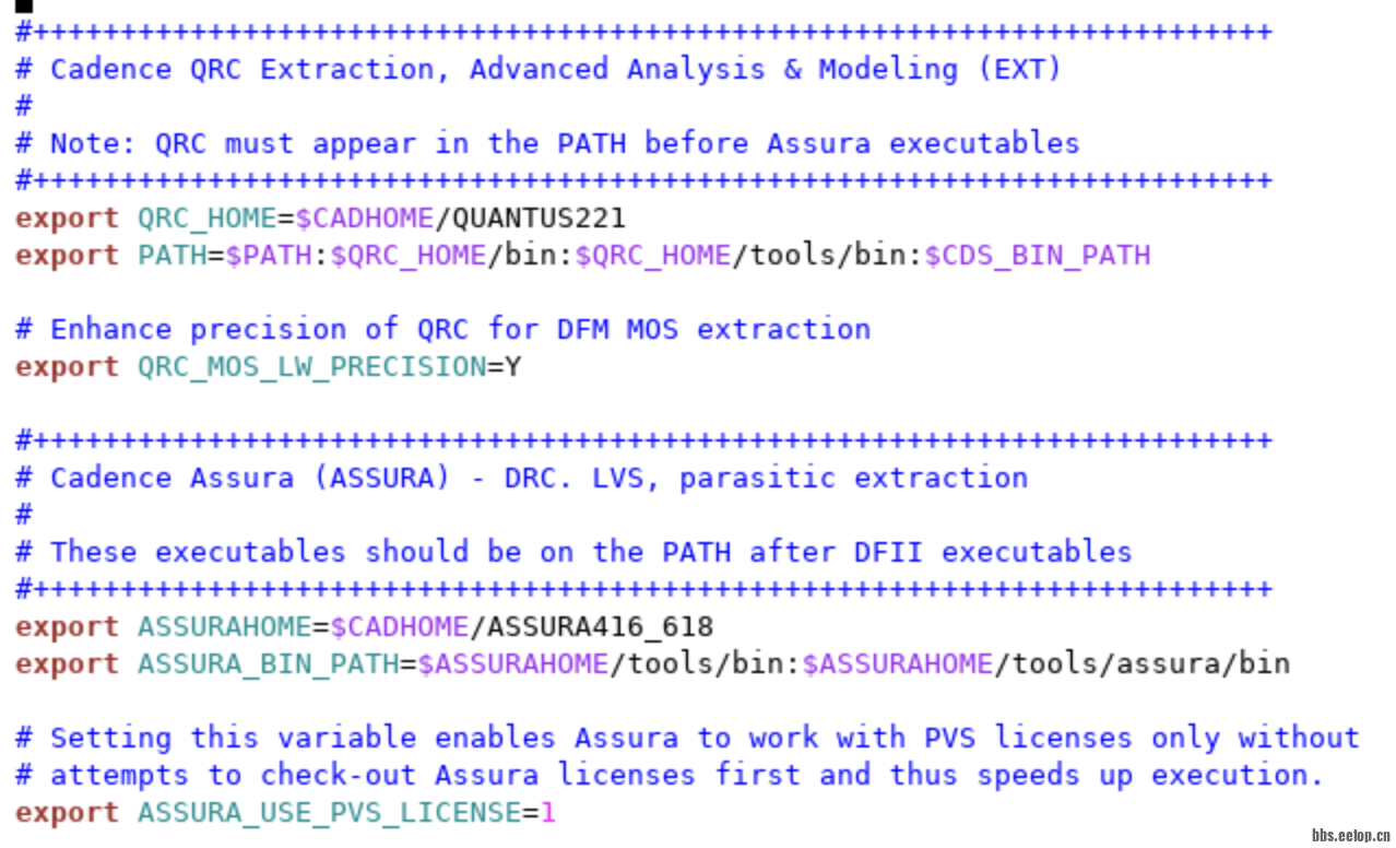

#+++++++++++++++++++++++++++++++++++++++++++++++++++++++++++++++++++++++ # Cadence Assura (ASSURA) - DRC. LVS, parasitic extraction # # These executables should be on the PATH after DFII executables #+++++++++++++++++++++++++++++++++++++++++++++++++++++++++++++++++++++++ export ASSURAHOME=$CADHOME/ASSURA41 export PATH=${PATH}ASSURAHOME/binASSURAHOME/tools/binASSURAHOME/tools/assura/bin

首先要确定在你执行 source .bashrc 之后准备好的环境变量中的PATH 保存的搜索路径中 QRC 的路径要在 Assura 的路径之前。如果还不行就要确定你的 .bashrc 里的OA_UNSUPPORTED_PLAT 的值是怎么设置的,按说ASSURA416-618 的安装路径里自带的 linux_rhel60_64 ,但在我的例子里我设置的 OA_UNSUPPORTED_PLAT=linux_rhel50_gcc48x
