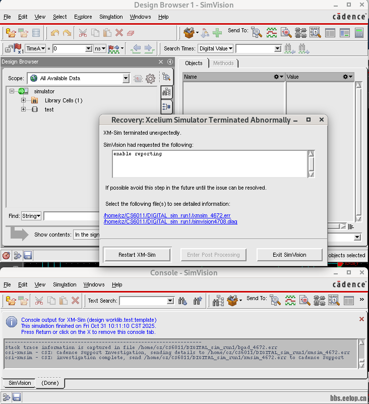

Rocky9下安装了XCELIUM2403,从virtuoso中调用,运行仿真提示如图错误,查看生成的文件,错误提示为:
External Code in function: <unavailable> offset -65521
Simulator Snap Shot: top level instance (SSS_TLI) in snapshot worklib.test:template (SSS)
Error: Error processing stack frame(12) - skipping rest of frame!
Intermediate File: array of pointers (IF_PTRBLK) in snapshot worklib.test:template (SSS)
External Code in function: <unavailable> offset -63488
Simulator Snap Shot: dynlib (SSS_DYNLIB) in snapshot worklib.test:template (SSS)
请教是否有知道如何解决的?谢谢!谢谢!
 楼主| 发表于 6 天前 | 显示全部楼层
按照以下的命令修改:
sudo vi /etc/selinux/config
使得`SELINUX=enforcing`变为`SELINUX=disabled`,重启以后就可以了。
